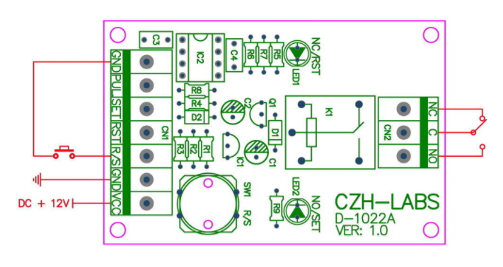

Correct me if I'm wrong but it sounds like you need some sort of latch system, which is always latched On but you switch the latch Off with a momentary pushbutton. Similar to like a starter motor, but linking out the start button.
I can't read the full description of this item, but you could ask the seller if this will do what you want.
Does your 'accessory' take more than 10A?

I think you could a achieve this with a relay with both normally open And normally closed contacts. 12v from the ignition feed would go to the COMMON pin on the realy. The NC contact would feed the accessory. The NO feed would go to power the relay coil. The other side of the coild would then connect to ground.
You would also need 12v feed to go via your switch (which would need to be a non latching push button of some kind) to the relay coil.
When you push the button the relay will change over from the NC contact (disconnecting your accessory) to the NO contact (powering it's self). It will hold it's self in this position until the power is killed (ignition off) when in will switch back to the accessory ready for next time you start the car.

This might be what you are looking for?
Cartek Fog Light Switch Control Unit | Demon Tweeks - https://www.demon-tweeks.co.uk/motorsport/accessories/cartek-fog-light-switch-control-unit
If your accessory is powered via a normally closed relay, then this switch can be used to turn it off. When you turn ignition off it will come back on again.
I've no experience of this unit but it looks like it will do what you want?
Thanks for your help! This is pretty much exactly what I needed.
