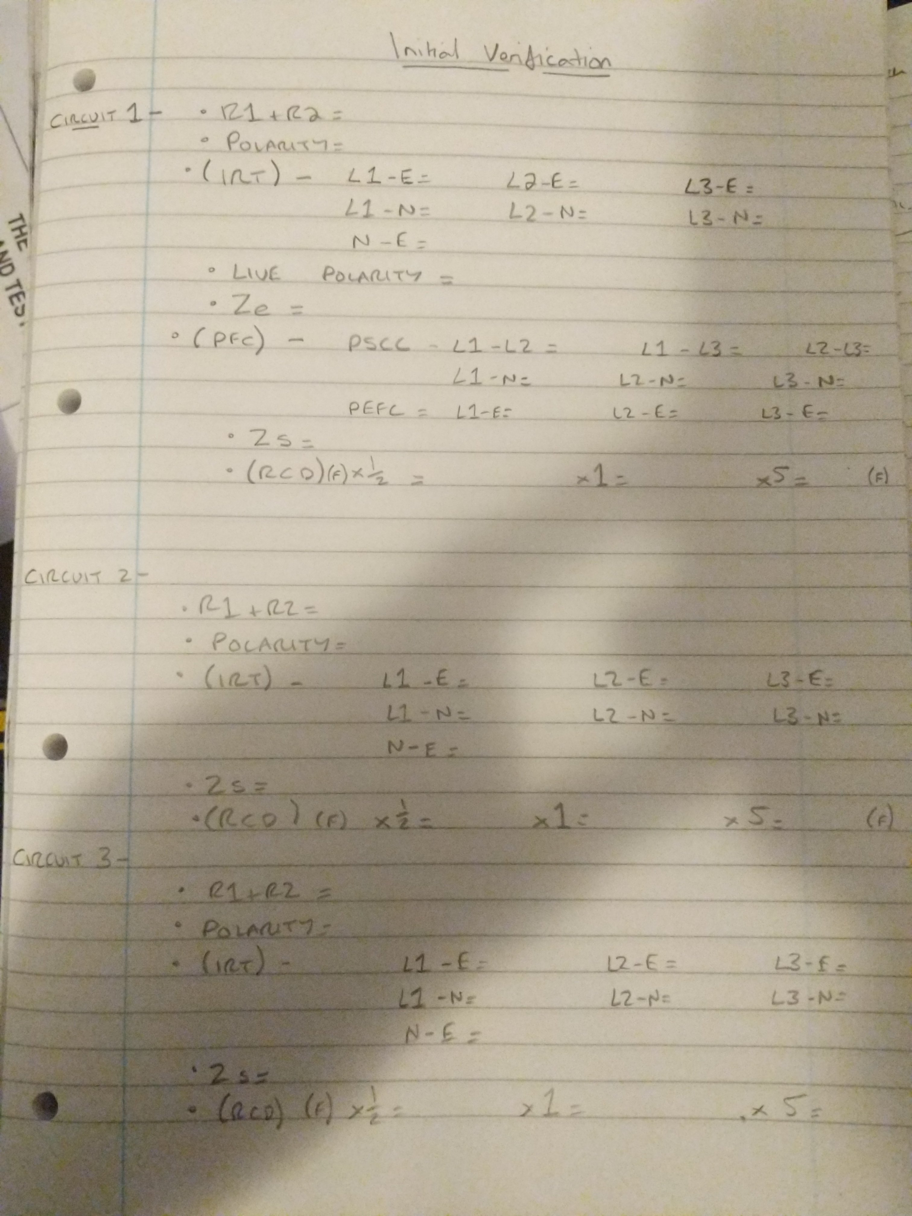

I have my practical assessment for 2392-52 tomorrow. I've passed everything so far and only have this to do. It's 3 hour assessment which includes, initial verification on 3 circuits (three phase), periodic inspection and test of 3 circuits (single phase) and fault finding.
I'm just trying to get things prepped to help keep the process smooth and not waste time. The 3 hours includes time to fill all relevant paperwork.
I have made this little breakdown for me to record readings on the initial verification side of things.
The breakdown iv done is below. Do you think I have covered everything? I've put all supply characteristics within circuit 1 but not 2 and 3 as they will be the same.
