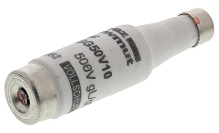

Get this class for a body shop welder.....'nuff said.
  • 3/5/13 Amp Fuses For Plugs And Fused Spurs... 20190110_143858 - EletriciansForums.net
Looks OK to me, I think it's one of these:
3/5/13 Amp Fuses For Plugs And Fused Spurs... D1 fuse - EletriciansForums.net
