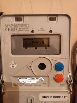

Hoping to get some info on 3 phase meters.
Family has a place out in the country. It needs to get the meter replaced, but seemingly it's a 3 phase meter.
Scottish Power has organised this but have cancelled the job as none are available.
So my question is, could the job not be done with an "ordinary" meter?
I'm told it needs a 3 phase model because of some old storage heaters.
The existing meter has 3 read outs - day, night, and control. It seems it's this 'control' reading that's causing a problem.
Would appreciate any info, thanks.

Are you sure you have your terminology correct? A three-phase meter (which woul be rare in an existing domestic property) is entirely different to a meter capable of three different readings, which is what you seem to be discussing??

I'm told it's a 3 phase meter. I wouldn't know how to distinguish between that and a 'normal one' And yes, it's a domestic cottage.
I've got a photo of the meter. Attached. From memory you need to press a button to scroll through the three readings.

That is a single phase economy 7 meter look at the top left of the meter

The fact that it's also a radio telemeter could be part of reason for the availability problem, perhaps.
