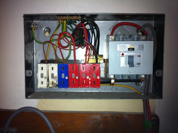

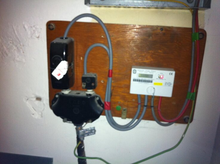

im asking due to a PIR on this install.
cant identify the cut out rating and the tails look very small, from the cutout to the meter is 16mm, out the meter to CU looks smaller to me, poss 10mm..
also signs of overloading on lights, (cant see how though, only 5 pendants on the circuit)
and broken fuse carrier
and no cover on the front for the fuses

I can't comment on the tails size from a photo.
The discolouring on the second white fuse carrier looks like 'flash' to me, from where a BS3036 has 'blown' on a fault.
They don't make 'em like that any more (thank god).
That was my first thought but then noticed the customer had put 15a fuse wire in to replace the 5.
the tails had been doubled back in the terminals which is why i thought they were 10mm. could be one of the old dodgy size conductors.
