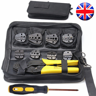

Was just going to use 4.8mm spade terminals with a cheap pair of ratchet crimps.
If I were using grey NAC3...B outlets with 4.8mm terminals, my preference would be to solder. I don't like 4.8's very much at all and certainly not at 20A, most are only 'rated' to 15 with a trailing wind. 6.3mm as used on True1's are better although not perfect.
So I've gone from soldering to crimping back to soldering... So right now I usually use this lead free 'silver bearing Rosin core' solder. I have a nice enough chinese 90-110w digital iron. What is the best solder to use for a joint like this... Highest melting point? Once soldered should I tape the joint up, wrapping around the powercon or sleeve each tab then sleeve each individual connection then put on a rubber sleeve in the event the joint breaks it will just be loose in it's rubber sleeve.

Then from the blocks 4mm tri to the neutrik 20a sockets through MCB. They will be crimped using:
and I will use neutrik faston 4.8mm connectors rather than 4.8mm spades as they may only be rated for 15a and I know the neutriks are 20a. I will then heatsink the faston and use the SCDR sleeves
