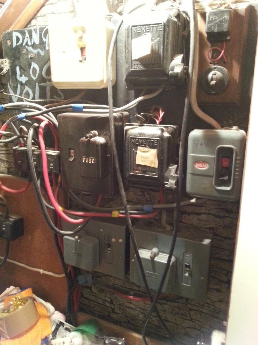

Was asked to carry out a EICR and found this! One saving grace is the storage heating on a separate phase has been disconnected. My personal favourite is the fuse carrier with a live tail from the meter exposed just where you would put your thumb to remove the carrier to replace the fuse wire! and still the customer questioned why I said the condition of installation was unsatisfactory!!

Yay ! Fused neutrals for the win !!! lolz
thats a C1 right there !
and i like the 400v warning graffitti by banksey :)
and some of that is older than 50yrs i'd bet ;-)
Yes there was more than a couple C1's on the sheet lol I made the Wylex board "safer" with a blank I had from a CU change I done the other day. Got better as each room only had one socket some changed to double's all with multiple socket extensions.
Its a Fuse both carriers are identical and marked 15A 26SWG MAX and both have a fuse wire in not to mention the splayed switching connector and bent switch link.
Its a Fuse both carriers are identical and marked 15A 26SWG MAX and both have a fuse wire in not to mention the splayed switching connector and bent switch link and the unshielded exposed live terminals and the unprotected cable entering the top and lack of ip4x on top surface........
fixed that for ya :)

The property is in Chiswick converted in to two flats in the 60s all the switchgear is in use except for the old heating boards not fully in shot at the bottom. It was two phase and neutral but now single though the second phase is in a block and still live.
other than the switchgear, installation methods of switchgear and one old light fitting where heat had destroyed the insulation the circuits tested ok.
tested most from ends so I didn't disturb the switchgear too much just cliped on links and tested the ring from a central point
have listed multiple C1s advised remove all old switchgear fit new CU upgrade earthing advised customer to contact dno to have supply blocks changed as damaged and a isolator fitted and the second redundant phase removed or isolated rewire light circui in cupboard.
Agree, the sooner all that superfluous crud is out of the way and replaced by a single CU for each apartment/flat the better!!
