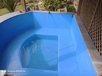

Hi All, Havent posted for a while but would appreciate some opinions..
See pics for hot tub arrangement that I've been asked to provide power for..
A local tradesman had already built this when I was brought in and the clients are existing customers of mine who had booked in lots of other work.

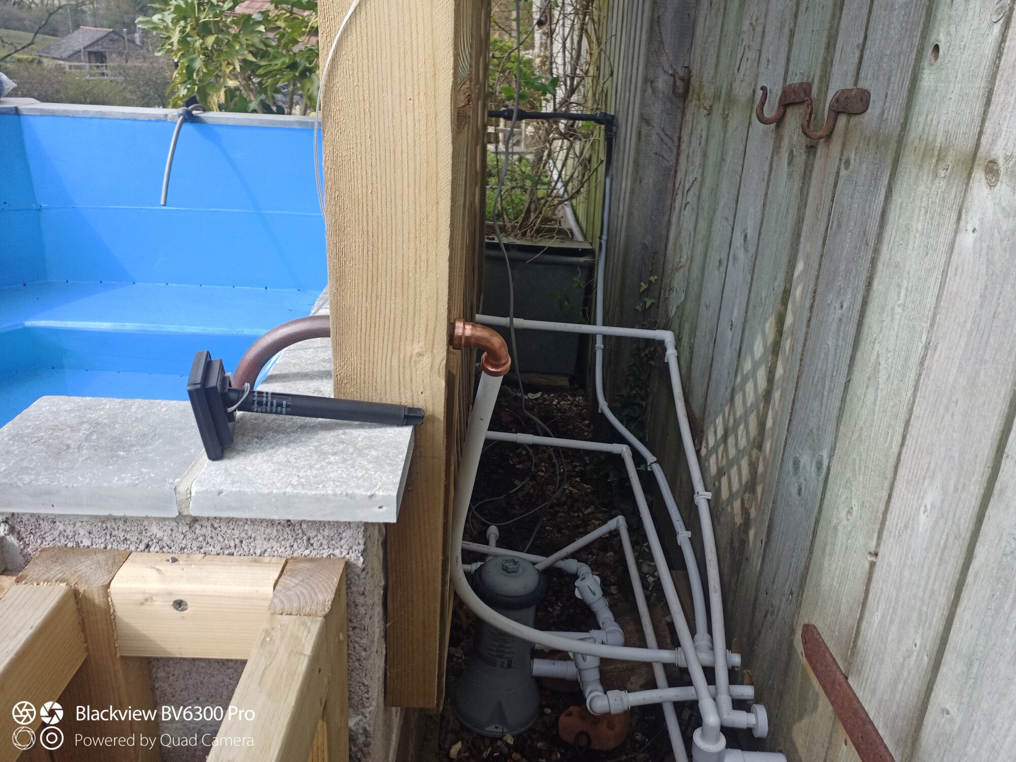

He has used 2 plug and play pump/heater sets that are coupled together in some way and all the pipework within the structure is plastic apart from 2 copper bends as seen in pic.
I have provided power into several adjacent buildings from a remote 3 phase incoming supply. The whole site is on TT earthing.

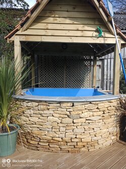

The structure sits on a steel reinforced slab and is constructed of concrete / natural stone / brick.
There will be no class 1 equipment in zones 0 or 1 (sec 702 applies I'm sure) but I'm sure there will be plugged in stuff everywhere , they are party types and have 4 sons teens/20s.
Bonding..? rebar in slab is inaccessible (builder told me he'd get to it but hasn't yet) but I'm sure it will be an extraneous conductive part..the copper bends are not as tested today but when everything is wet?
In short I have concerns that the design is a bit of a lash-up but need to do the right thing...should I bond or not?
Forgot to say the thing is surrounded by wooden decking which 1 of the sons has peppered with mickey mouse LEDs, thankfully SELV. Cheers John

? I hate hot tubs at the best of times but this one takes the cake, its leaking like a sieve anyway so hopefully demolition followed by the installation of something more...er....plastic
home brew hot tub.... dodgy AF
Whats the twin and earth just dangling in beside the pipework?
And speaking of which.... the pipes arent lagged... any hot water is going to be cooled before it gets to the duck pond
Why didnt they just buy a proper tub and build the tiki hut around it

Presumably he didn't employ a plumber, looking at all that push fit mess?!

I don't think the 2 copper bends would need bonding, given all the plastic pipe supplying it...Is it plastic from the source too, or is there copper in that shed?
Rebar might be a different matter and could be tested, but I'd probably supplementary bond it.
As you say, almost certainly they are going to want to plug things in, so I'd be tempted to maybe put in RCD socket(s) in an appropriately compliant place, (maybe 10mA?) in addition to whatever RCD is protecting the supply...
As well as a big sign that says 'DO NOT CHARGE PHONES IN THIS HOTTUB"
If it were me then I would be looking at bonding the rebar or putting in a local earth rod to supplement the main TT earth. In most cases more rods are better!
I think @Dartlec idea of having a couple of 10mA RCD outlets as well as the normal 30mA "additional protection" on the supply side is a very good idea. Even if a supply RCD fails they still have some means of disconnection. The likes of MK make them such as this model:

Thanks for all the replies.
I am erring on the side of bonding the rebar, if I can get access to it...the builder assured me at the beginning that he could get at it but is now back pedalling..the pipe bends are over 1/2 a Mohm so not really worried about those, tub supply has its own stake that I fitted already with a pretty low Ra (12 ohm).
Great info about the 10mA RCD sockets, hadn't realised they were available, I have already fitted 2 x single IP rated Sockets in the shed behind hanging off a 30mA RCD but they are BG so should be able to retrofit a standard faceplate socket, if they are available as singles , will have to have a look. The dangling T&e is connected to a bulkhead light fitted by the builder, I was picking my battles with that one but it won't make the final edit...!
As far as heat loss goes, a heating engineer friend says it will be considerable!!

just to clarify, were you meaning use the 10mA sockets for the hot tub (2 x 13a) supplies or sockets to be used in the vicinity (within the confines of 702) ?
The pumps are remote (in the shed) I assume?
I was thinking 30mA at the source, then 10mA at any sockets , as a double protection just in case an RCD fails. Exceeds the 7671 requirements, but seems like a sensible precaution given the circumstances.
Though still worth making it very clear that nothing should be plugged in and used in the tub itself - most things will be SELV I guess, but who knows what quality the transformers will be...
That tub looks like something that hasn't been properly thought out, looking at it one thing I doubt is that it will be hot it might get luke warm but even that is being optimistic as it doesn't look as if it has any insulation between it and the concrete base
