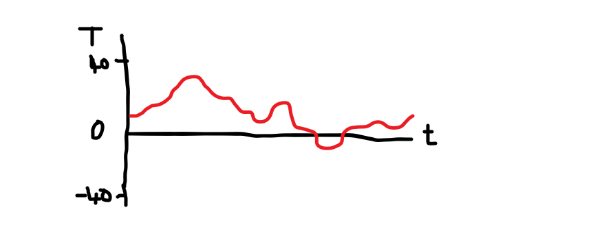

By way of some insight, if you measured the voltage produced by a sensor measuring ambient temperature during a 24 hour period and then plotted it against time you might see something like what I have drawn in the attachment. If I asked you 'what the temperature(voltage) was?' you would immediately ask me 'when?'. Or, if I asked you 'what was the average temperature(voltage)', you would have to ask me 'over what period?'.
The same sought of thinking applies to the voltmeters and what they display in the Proteus circuit you have drawn. What does the number on the Proteus voltmeter actually mean or represent? Is it an average value over some period or is it an instantaneous value or is it something else?
