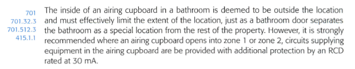

What do the regs say in regards to placing accessories in units inside a bathroom within zone 2
I need to a supply for a toilet pump but needs to sat inside a cupboard...
Thoughts please
