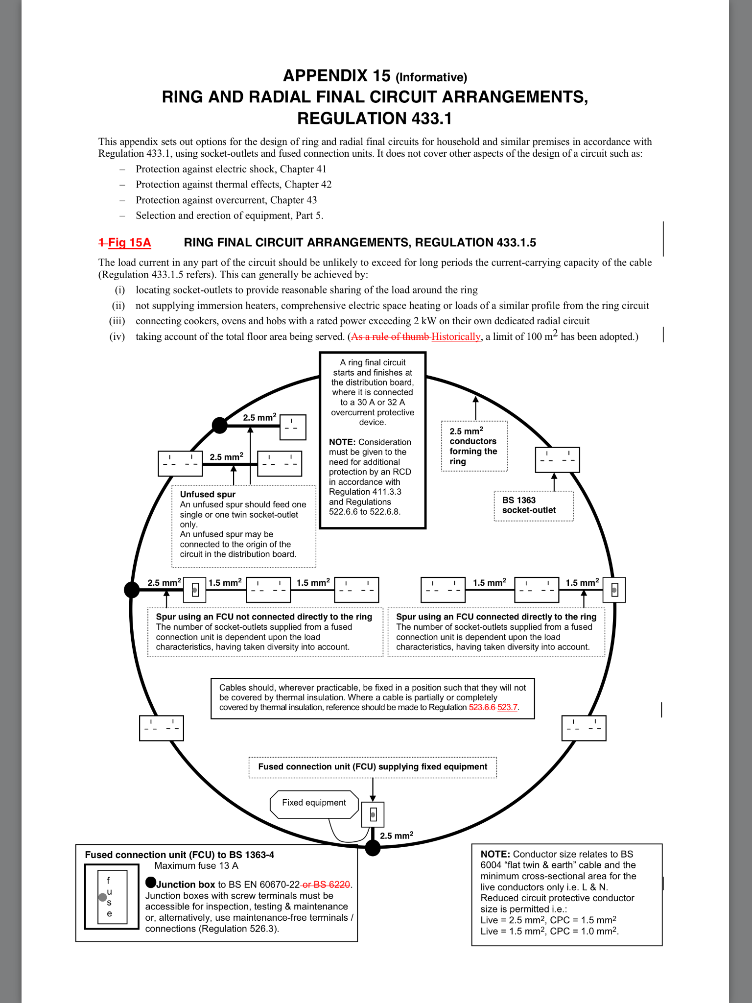

you'd need to fit a 13A RCD FCU,as you can only spur 1 socket outlet off a ring without fusing down.
Most definitely not - it's only the front bit of an RCD socket that's protected, not the terminals !
Edit - reply to OP, Tel nipped in before me.
Yes Anthony, but i want to spur off with more than one socket and nothing i plug in will no where near touch 13A
You don't want to add another RCD if the existing ring is already protected. Either extend the ring or fit an FCU with 13A fuse and feed your sockets from that.
