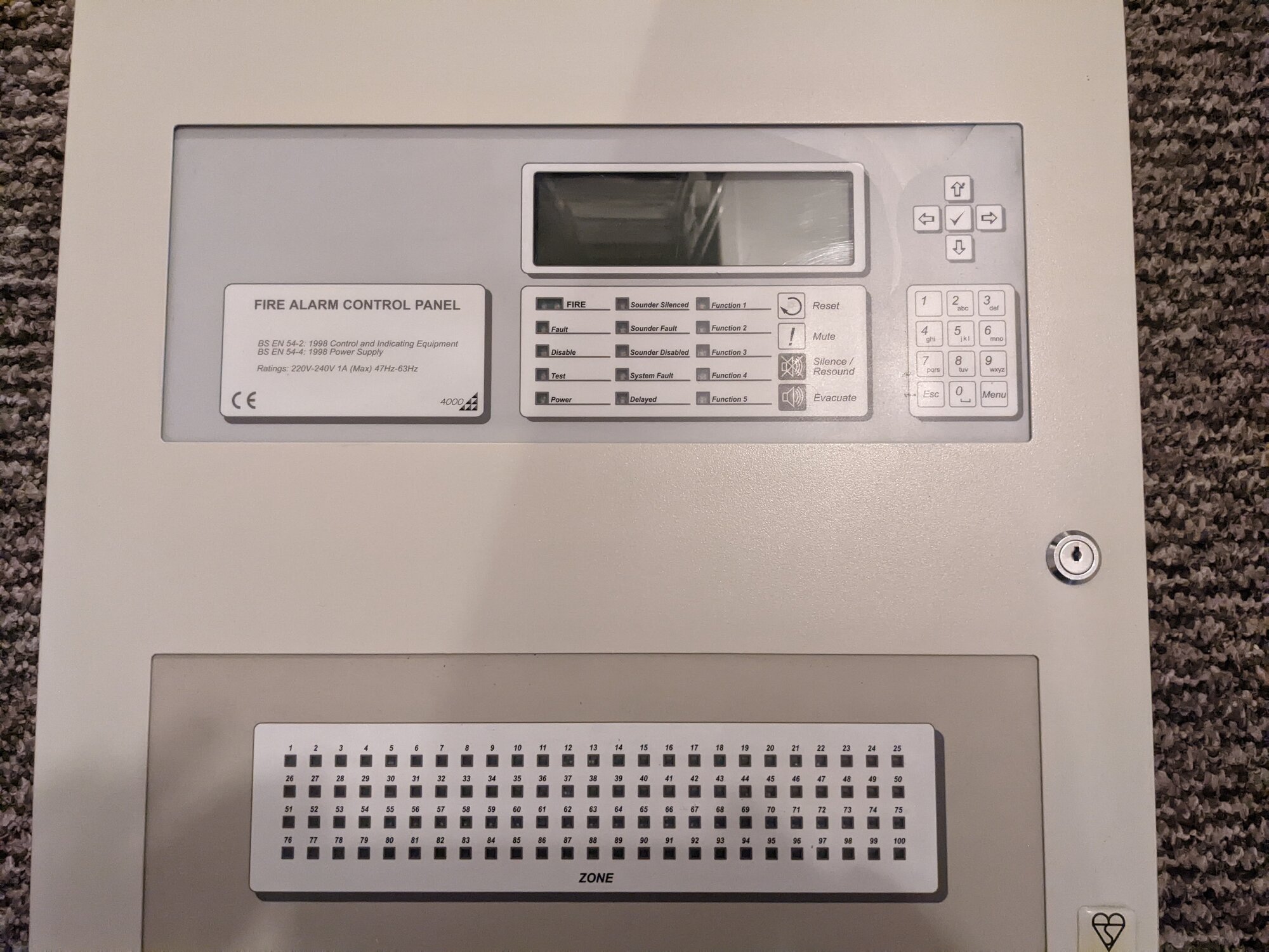

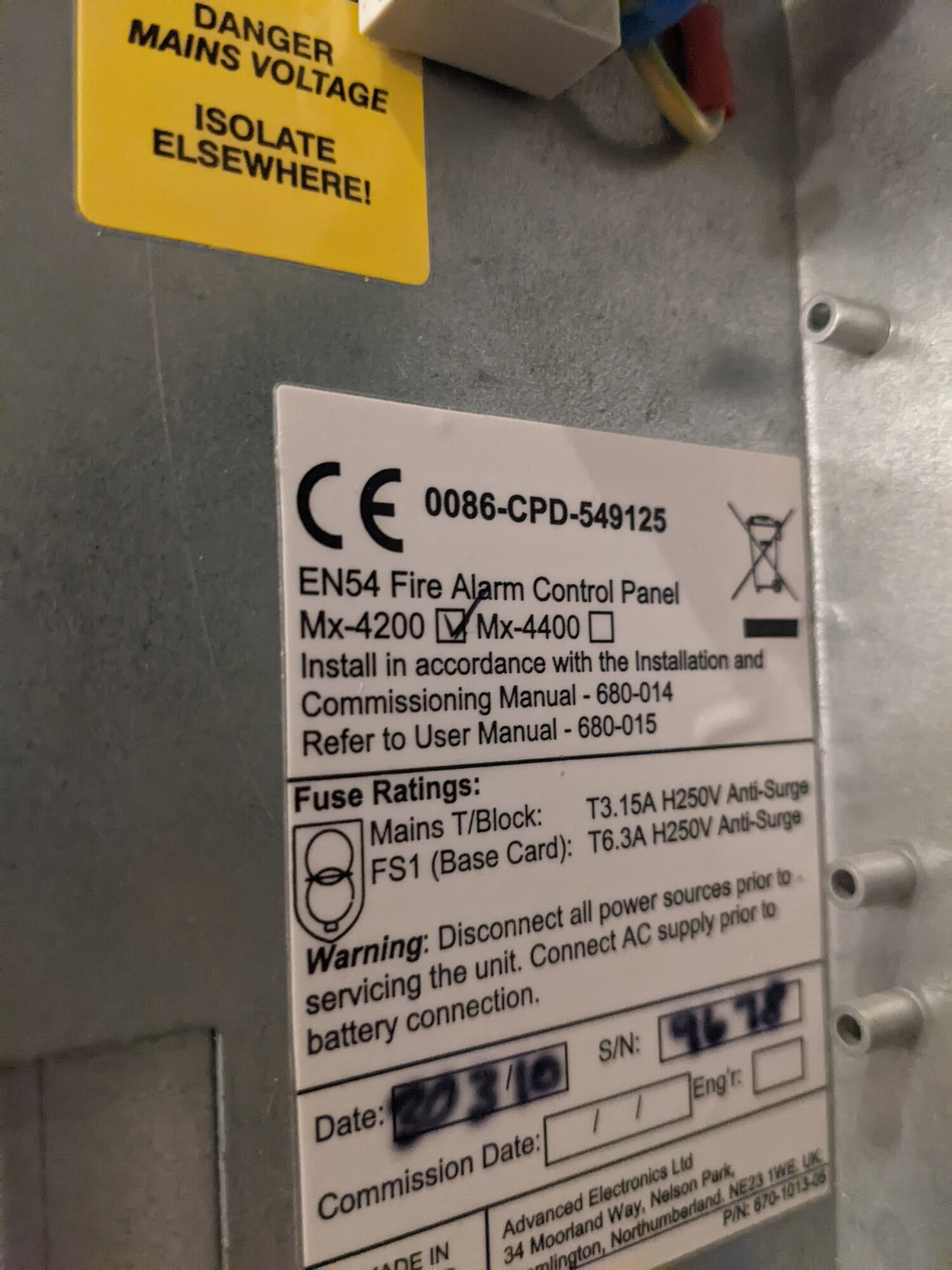

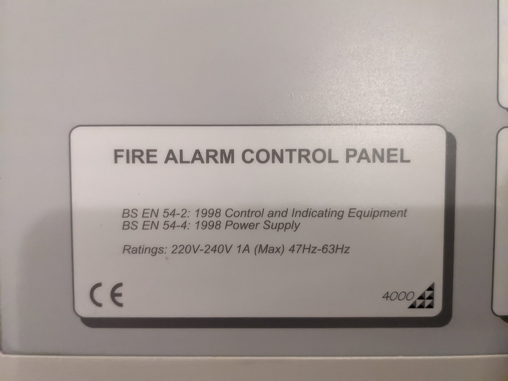

It's a big job and it's all designed. I'm just pulling cable in to the drawings. I just want to get a better understanding of how it all works. I've got a very basic understanding,but that's about it. I've got an old Advanced Mx panel in the loft and I've just bought some second hand Apollo XP95 kit off eBay (bases,smokes,VADS,I/O,MCP's) so I'm gonna try building a rig. There just doesn't seem to be much information online/YouTube etc like there is for electrical learners etc.
