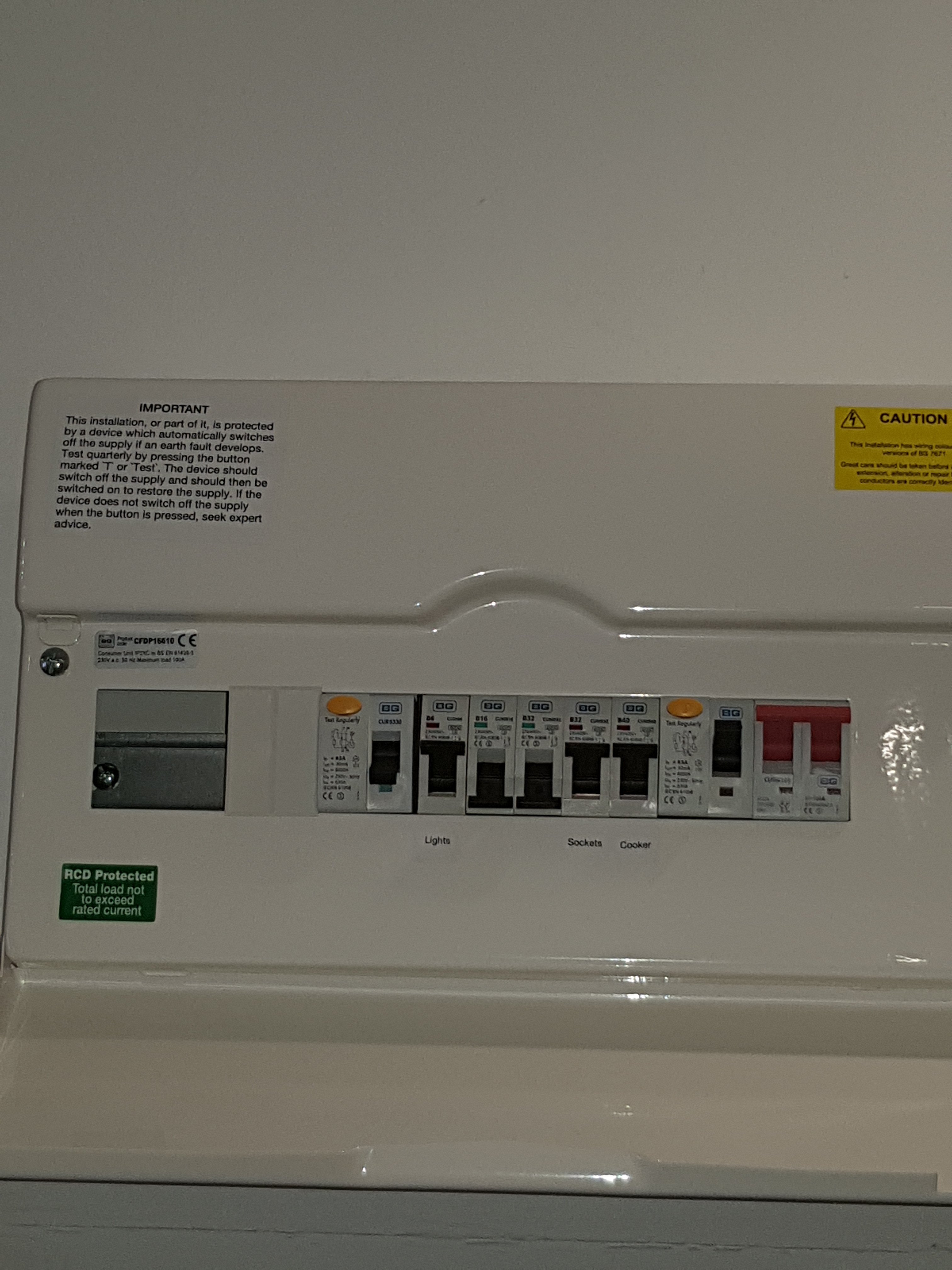

As soon as i see the fuseboard it looked new , as if it had been replaced recently.
I asked the tenant if he knew when it had been replaced he said yes last Friday.

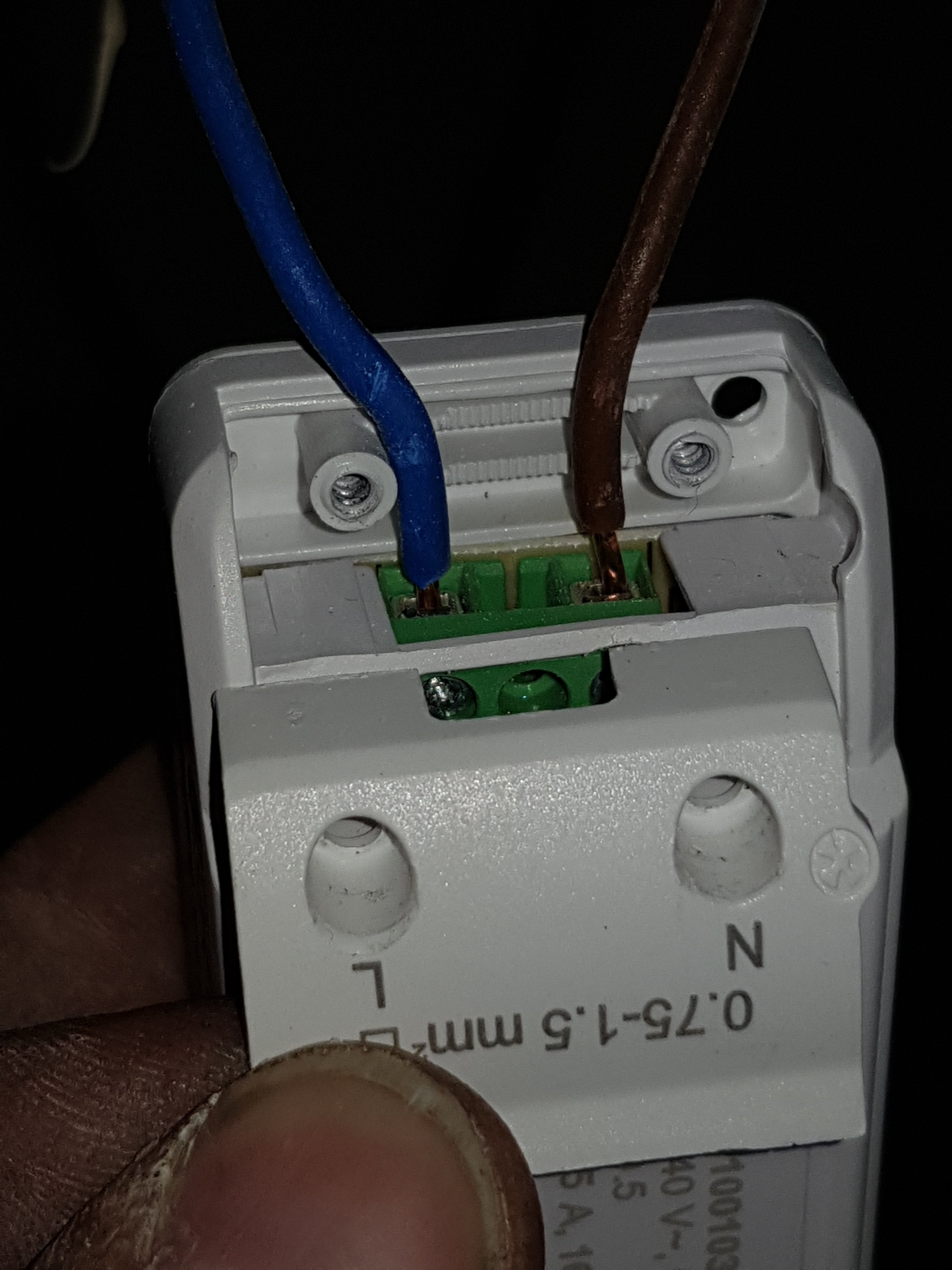

the tenant asked me to look at 2 LED downlights that the electrician also installed that kept flickering while turned off.
Please see pic of connections to the LED driver..... absolute disgrace.
Also below is a picture of the fuse board.
Code 1 straight away. It would have failed an EICR without even carrying out any testing.
