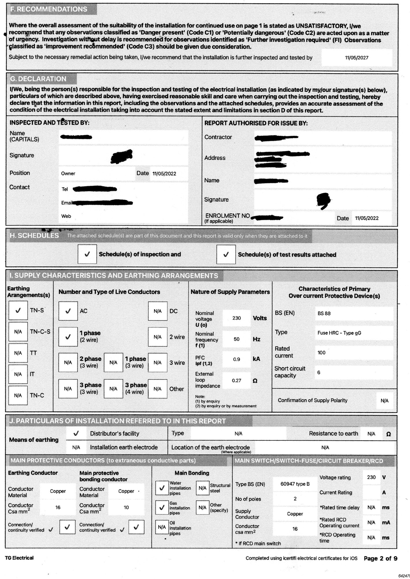

We were given certs for both Gas and Electric as per legal requirement but both are suspect given the major gas leak we had due to faulty installation of gas pipe to hob and our Electric one being done allegedy by a guy who works and lives 3 hours from here so a 6 hour round trip!
If you think the electrical cert is suspect if you redact any addresses and names you could post it on here for comment as it is usually quite easy to identify the suspect ones, including a 6 hour round trip into an EICR would make it a very expensive EICR

As per your recommendation UNG I printed off, then black marked the necessary info and scanned in the EICR.
Apologies it has taken a number of days to do, between dealing with other issues and having the words most temperamental printer scanner it's not been the easiest of tasks.
One question I will ask again is with regards building regs. So I read recently that in the case of a bathroom / near a water source this is classified as a "special location". If I understand this correctly, given the main bathroom we have now was previously 2 sperate rooms (Toilet in one, sink and bath in the other), these electrics are newly installed since the renovation.
Surely this sees them fall into the category of "special location" and should have seen them submitted to local building control? I may be getting that all wrong, just thought worth an ask.

The EICR looks ok to begin with, but RCD trip times on img004 are suspect.
The EICR will be somewhat redundant as any new work should have an EIC or Minor Works certificate that covers just the new alterations

In terms of the ECIR looking suspect, as I really have no idea when it comes to electrics can you advise a little more on this please.
The ECIR was done after these alterations had been made to the property, does that change it possibly being redundant?

The listed BS60898 is a standard protective device (MCB) and not an RCD, that MCB will not give you a trip time as the cert suggests. I don't see a mention that there is a main switch RCD either. I cannot make assumptions as to what is actually installed as I don't have that information, but for me the cert does not logically tally.

there is obviously a concern over the validity of the cert, just on the first pages suggests it was 25% tested, yet there are readings for every circuit which tells me it was 100% tested, there are no comments on the existing installation, None, think of this cert as an MOT certificate for your electrics, how often do you take an old car for an MOT and have no advisories. bring this up with the landlord or go directly to the accreditation company, quoting the enrolment number as they will have a complaint dept. that can look into their members.

To be fair, the 25% figure is the coverage of the report, ie testing and inspection. Its not necessarily saying that only 25% of circuits were tested, probably that 25% of accessories were removed and inspected.
Quick follow up while I think of it. Looking at the EICR again, it states approx age of the Wiring system to be 1 year. This suggests that the property was completely rewired whilst being renovated. As such it is highly likely this was done by the contractor (one guy) responsible to date for a multitude of issues.
As such, would rewiring a property require notice to Building regs and have to meet standards set out by them, and additionally would the person doing the work require by law to be trained and certified to any standard as per UK regs.
Carrying out a partial or full rewire will often involve creating new circuits or a consumer unit change. This means the work is notifiable to your local building control department. and the landlord would have received an Electrical Installation Certificate

Photograph of the consumer unit that the report corresponds to would be good.
The rcd time column should be filled in with the measured time displayed on a specialist RCD test device, which will be measured in milliseconds…. And should be less than 40ms.
