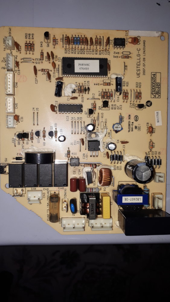

Hello friends. My air conditioner gives E6 error. It gives High / Low voltage error in the user manual. But when I measure the incoming energy, it's 220V. reading. I am uploading a few photos below. There is no energy in cable number 5 in the first picture. Does it have to be? The air conditioner comes from the outdoor unit to the indoor unit cable. I see it feeding the Out Fan in the air conditioner indoor unit. However, there is no energy due to the error, or is the problem arising from this?

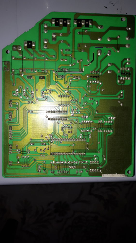

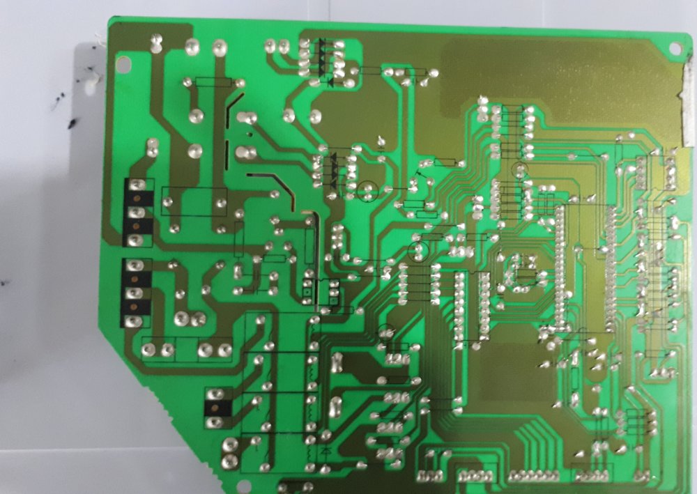

I upload the photo of the card and cable distribution picture inside the air conditioner. Does anyone have an idea? For example, everything is normal but the circuit measuring the voltage is defective. Can we bridge this?
I measured the output of the transformer inside the air conditioner, and I did not come across a problem.

1. Have you checked the fuse on the circuit board shown in image 3? It is found along the top edge just above the 4 black rectangular block components - which are relays.
2. Please tell me if:
a. the compressor starts;
b. the contactor 52C operates - does it have power?
c. the solenoid 20S operates - does it have power?
3. Please send me a photo of the reverse side of the main control board.

Thank you. It looks like the relays may not be operating.
Is there voltage on the blue wire from terminal 4?

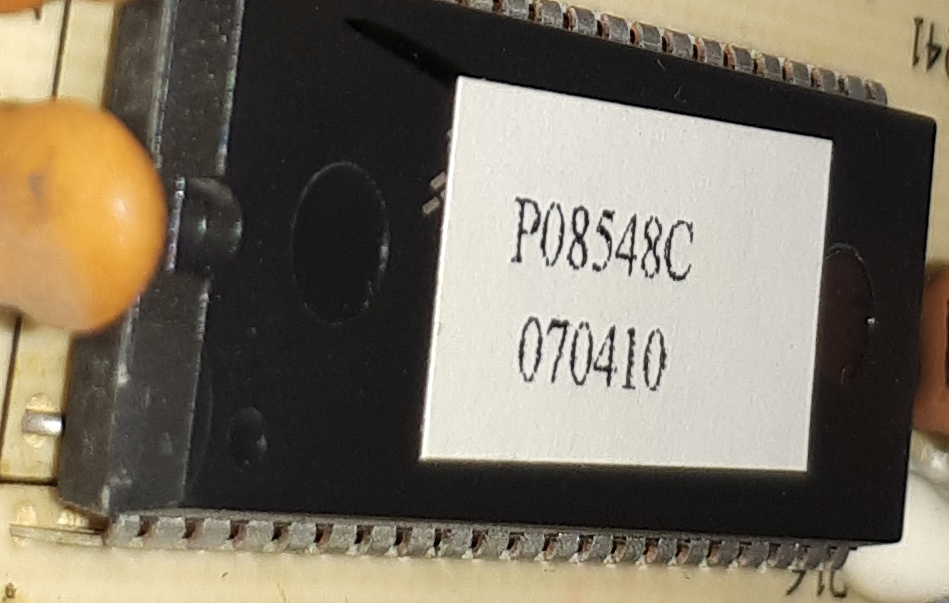

This is very helpful information. Do not forget to tell me the details on the 16 leg/pin integrated circuit.

Good morning dodo41. Thank you for the photos.
Please use your Uni-T meter to measure three direct current voltages - V1, V2 and V3 - as I have described in the attachment turkaircon below. Set meter to dc 0-20Volts
When you do this all the connections need to made to the main circuit board and the 220V ac turned on - so be very careful. Only measure the voltages I have asked for.
Take care not to short pins together on the 'blue' or 'orange' components.
