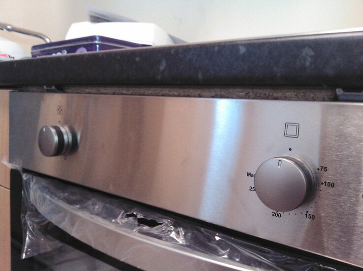

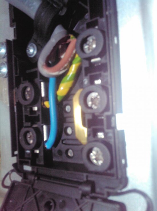

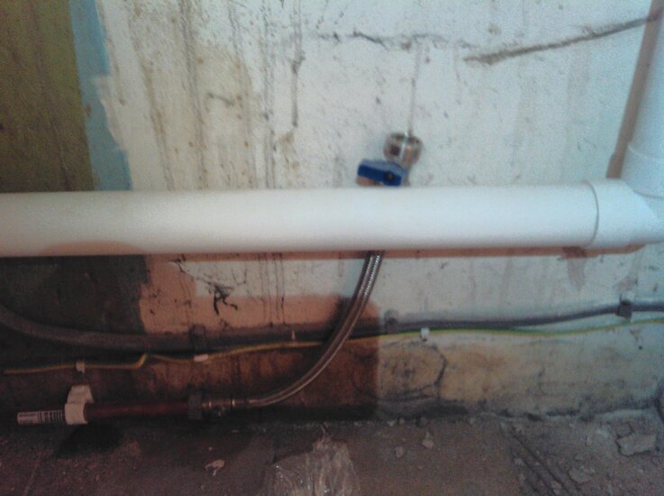

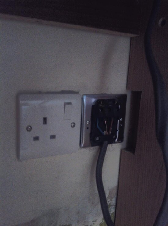

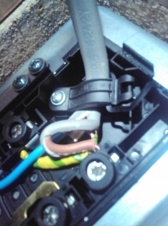

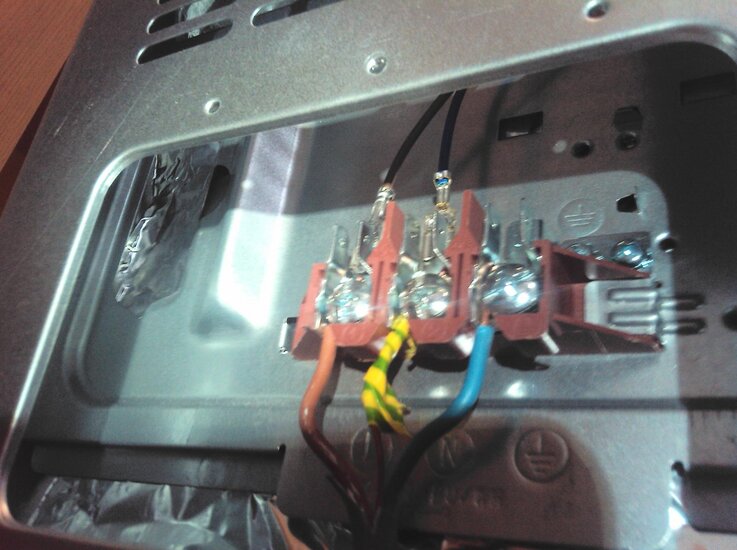

oh yet another one of those days eh , job im working on kitchen fitter / odd job man wired in the hob and oven hob is 8.7kw so 2.5 ok look closely at the live yes it is touching the cpc , if you look you'll see it wont work as its been connected to an unused terminal in on a big lable was the cable size type and of course the connections and then the oven well beggars belief , and of course one for the plumbers how not to plumb in a washing machine water feed yes its wedged between the waste and the the wall oh and have a look how the oven fits you can see from the pics is the 2 clamps for the hob at the top of the oven , why do we bother ehAnd todays pudding goes to the odd job man huw owen 011 - EletriciansForums.net
