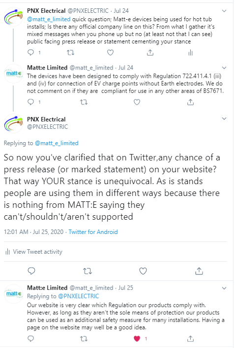

Of course another alternative might be the ev charger devices. I know there's a little bit of mocking about this, on the you tube sparks, but it is mention at the end of this piece.
@Midwest ive been chatting to Matt-e about this very thing this week. They say their devices are only for ev chargers despite what Super sparks Gifford says.

I've just watched John Wards vid on ev chargers (June 2020). He's not convinced that those devices will disconnect on all occasions, with a pen disconnect.
