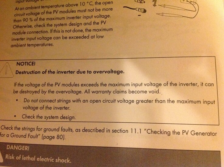

You could argue (manufactures words) - over voltage on the dc side of the inverter can seriously damage the inverters internal components. No doubt your client could ask for the inverter to be sent back to manufactures for a thorough inspection to assess any possible damage as the inverter has been overloaded (is that the correct terminology? Over volted?)
Joe
The actual extract (from a TL booklet but I'd imagine they were all similar warnings)

re overvoltage damage - it'll only affect the varistors until the varistors are destroyed, after which the rest of the inverter would swiftly follow. As the varistors have a design life of 1000 uses (IIRC), and there are 2 of them, I seriously doubt that's going to be an issue at this stage, presuming it's a recent install. They could ask for a pair of replacement varistors if they wanted, but I doubt they'd need them.
