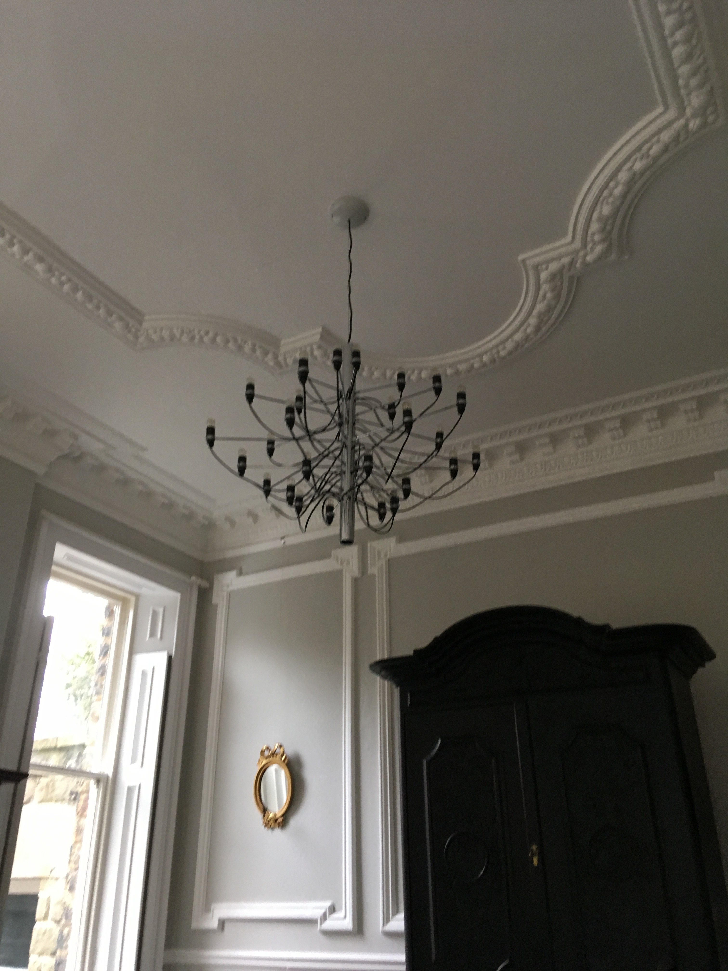

61240FE7-826D-406E-9383-5D4A60A05E1D.jpeg 8912B7D2-6B2A-4CAB-A23B-70E395BE1F70.jpeg Logo in the bottom right corner - looks like I shouldn’t be installing them in a home.
Also - 30 of them needed per lamp at 15w each - two lights (one already installed by customer) + other lights.
It’s right up close to maximum demand - even with diversity.....
Customer supplied lamps - time for a chat - but to put LED’s in will cost £££££
View attachment 47654 View attachment 47653 Logo in the bottom right corner - looks like I shouldn’t be installing them in a home.

The symbol means that it is not intended for general domestic lighting use because it does not meet the minimum efficiency requirement. For example, a fitting with those in won't comply with part L, so they can't be sold as GLS lamps.

He also wants them dimmed.
So that’s 900 watts through a dimmer. I think they are rated to 600 Watts max.
In a 16mm box.
Oh dear.
