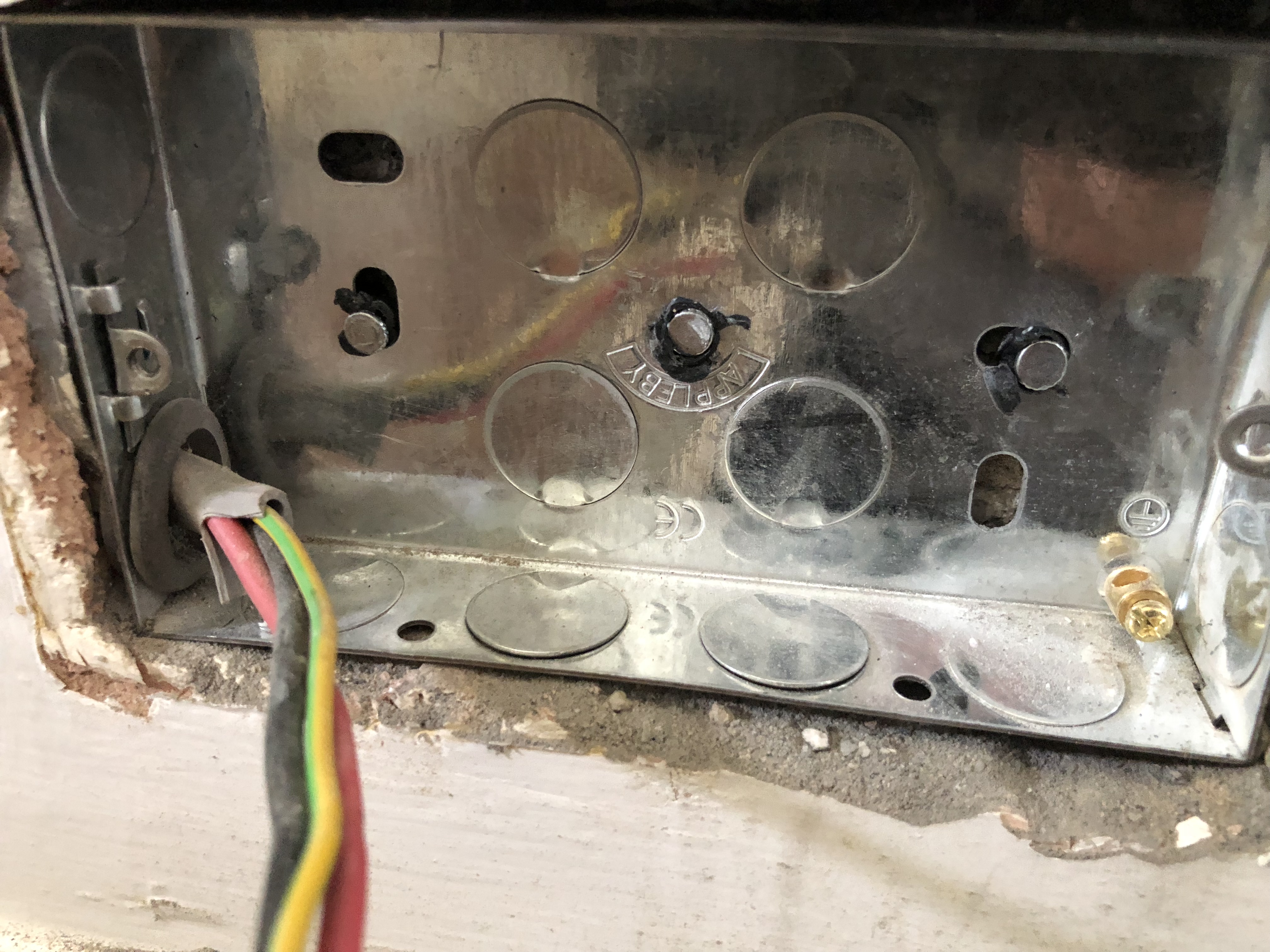

Backboxes, hold straight, then bang, bang.
Only problem with backbox’s is if you dont get it straight first time, you cant loosen the screw to adjust.

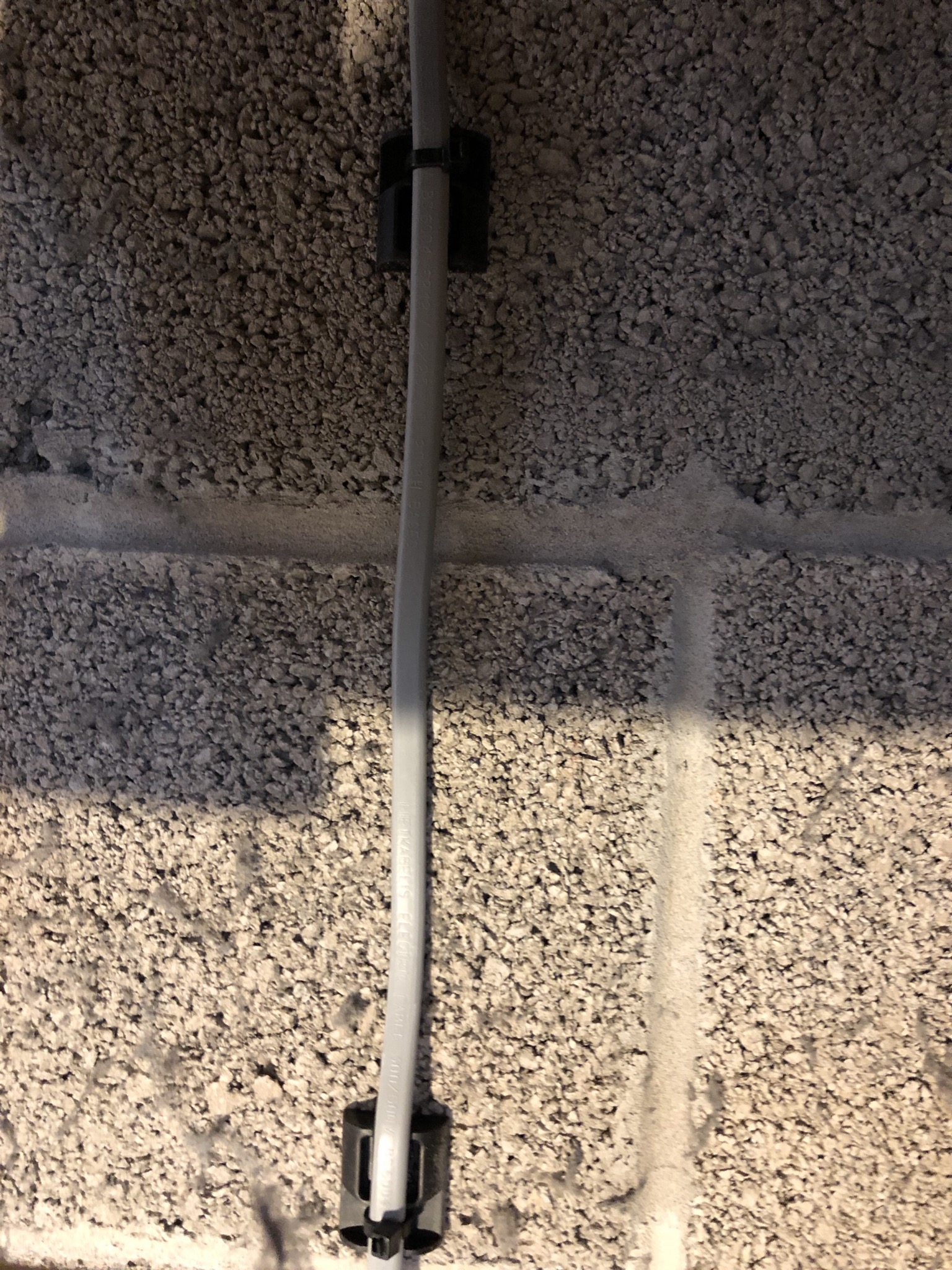

Plastic conduit, the P clips hold in the tip of the gun, hold the conduit where you want, place the clip and gun over and fire.
Clipping cable direct (SWA, Flex or even T+E), push cable tie base onto gun, press against wall, Fire, then cable tie cable to base.

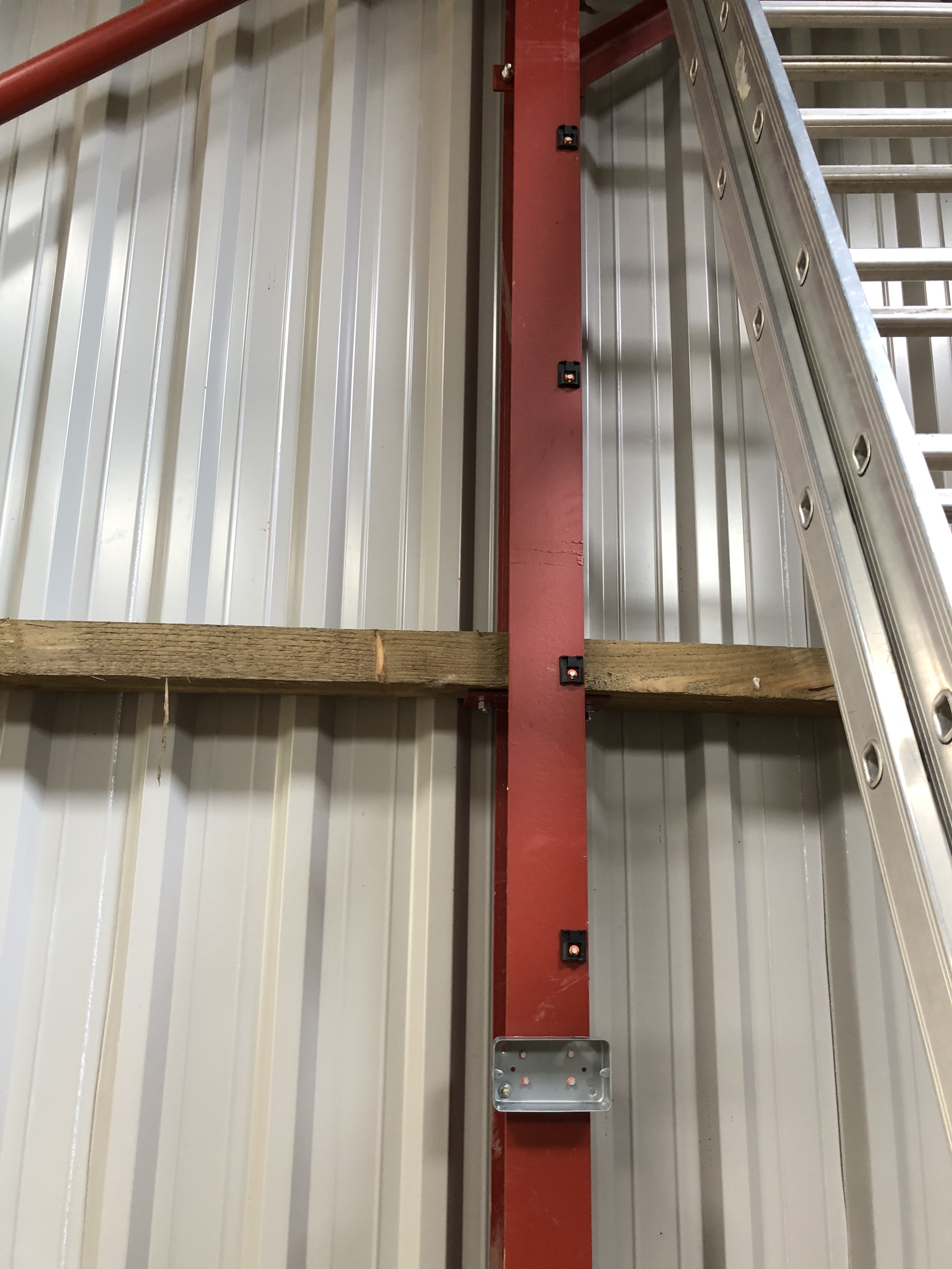

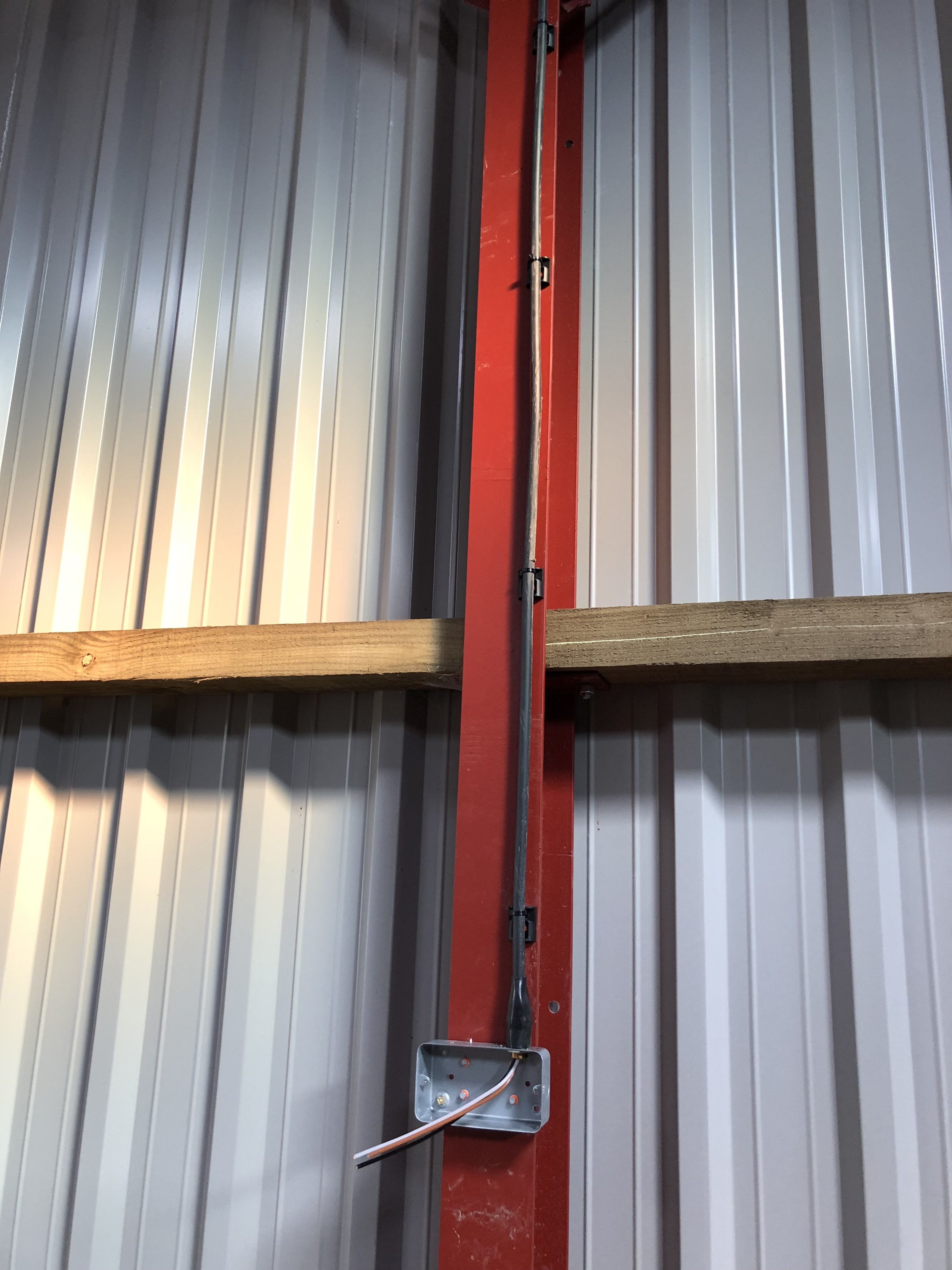

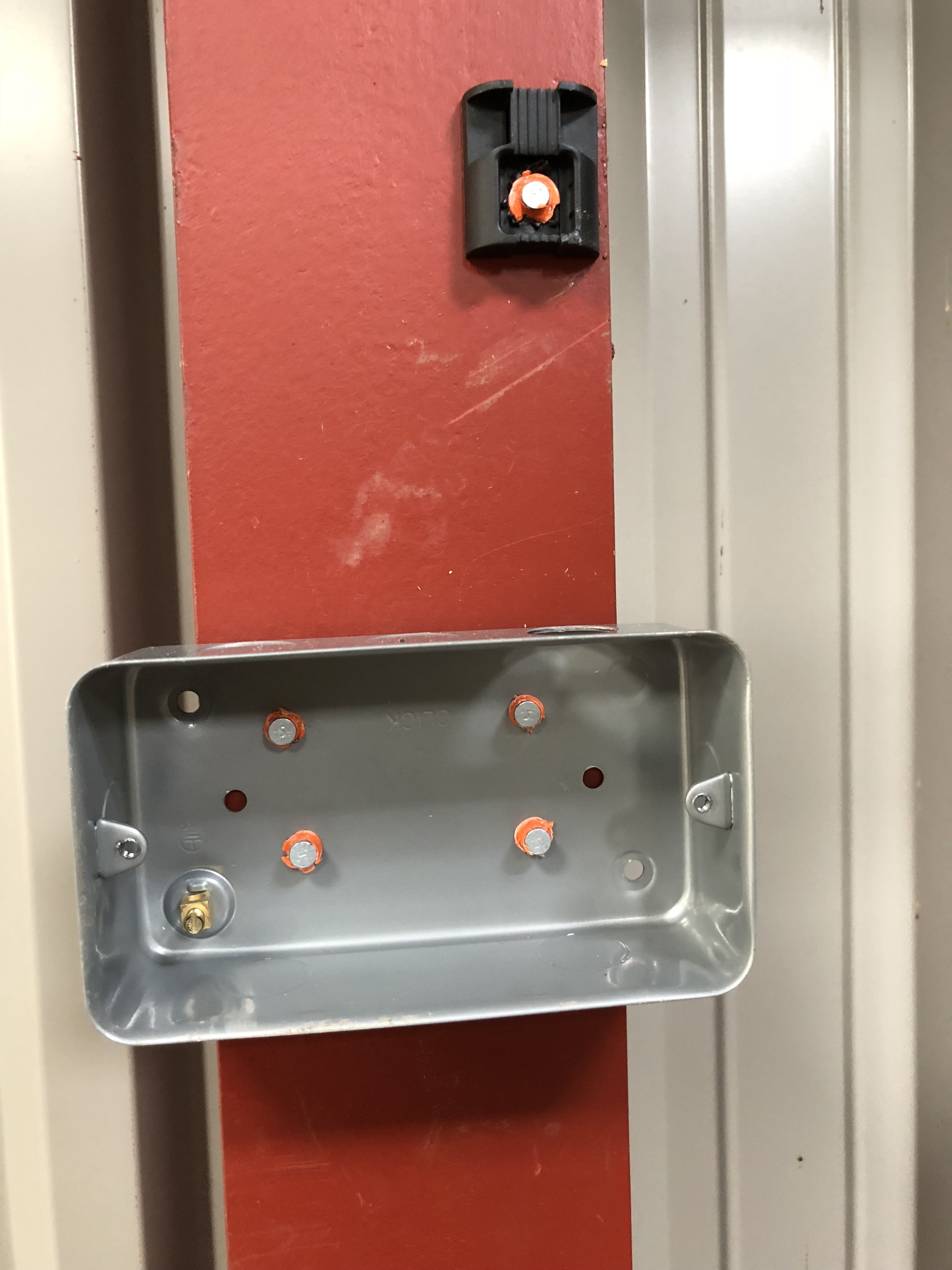

I have a job next week where i need to clip some SWA to 8mm steel girder, so have just ordered some 15mm hard concrete/steel nails to give it ago in steel.
However i can't get into my head how a nail could possibly go into 8mm steel :eek:
