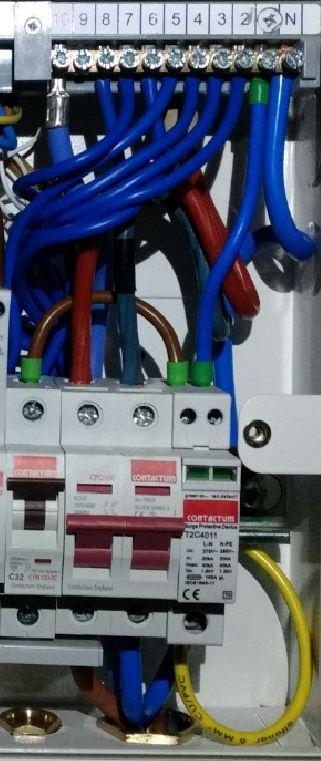

Sorry I meant a LVE board , I’ve seen a LVE board with surge protection already installed in it , the SPD is before the main switch in this board , this got me confused.

This picture illustrates @DPG 's point perfectly. Physically it appears before if you're looking from right to left, but wiring wise it's most definitely after the main switch.

When you say the SPD is before the main switch, do you mean physical position or actual wiring order though?

in LVE , SPD is before main switch Are surge protection devices fitted before or after the main switch image - EletriciansForums.net

In the LVE board it’s before main switch, I’m trying to understand this and the way it’s wired, it appears to be wired before the main switch aswell.Are surge protection devices fitted before or after the main switch image - EletriciansForums.net

in LVE , SPD is before main switch View attachment 54817

In the LVE board it’s before main switch, I’m trying to understand this and the way it’s wired, it appears to be wired before the main switch aswell.View attachment 54818
In that style of board the SPD is after the main switch. The meter tails terminate into the top of the main switch.
Ideally on an installation all consumer equipment should be after a main switch to allow for safe isolation. But if the supply was split before the main switch then the SPD would have to be before the switch as it is designed to protect the installation and not just the board..

Refering to your LVE board , The incomming tails would terminate into the top of the main switch, so the SPD would be after the main switch.
Sorry I’ve looking at this in the wrong way , the SPD is after the main switch and is pre wired , no need for over current protection , think I’ve got that now

When SPD is after main switch and is pre wired , then the is no current flowing through it , am I correct .
Whether it needs over current protection is down to the manufacturer.
SPDs are typically metal oxide varistors... At mains voltage these are high resistance and consequently pass no to little current. As the voltage increases, there resistance drops and they conduct more current, dumping the spikes to earth. They may also has discharge arrestors (I think that's what they are called).
The same technology is present in surge arresting extensions which can cause low insulation resistance readings (tip... If an IR test is poor at 500v, if it's good at 250v, it's possibly a surge arrester in circuit).
In normal circumstances there is no current flowing through them. They only become active if transient voltages occur diverting them to earth before it can cause possible damage to equipment. In your pic an earth is required from the device to the consumer unit earth terminal.
