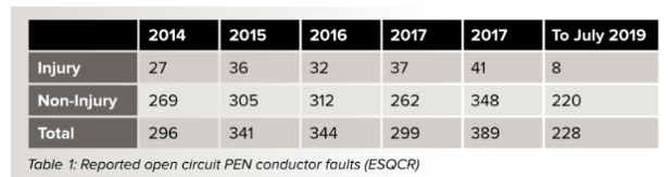

I have it in writing from 3 DNOs (every one that I have contacted so far) that they have no special requirements regarding earthing arrangements at outbuildings
how many faults per year on pme lost neutral very little the power lines are monitored ,you have got more chances of being kissed on the lips of a giraffe 🦒.
