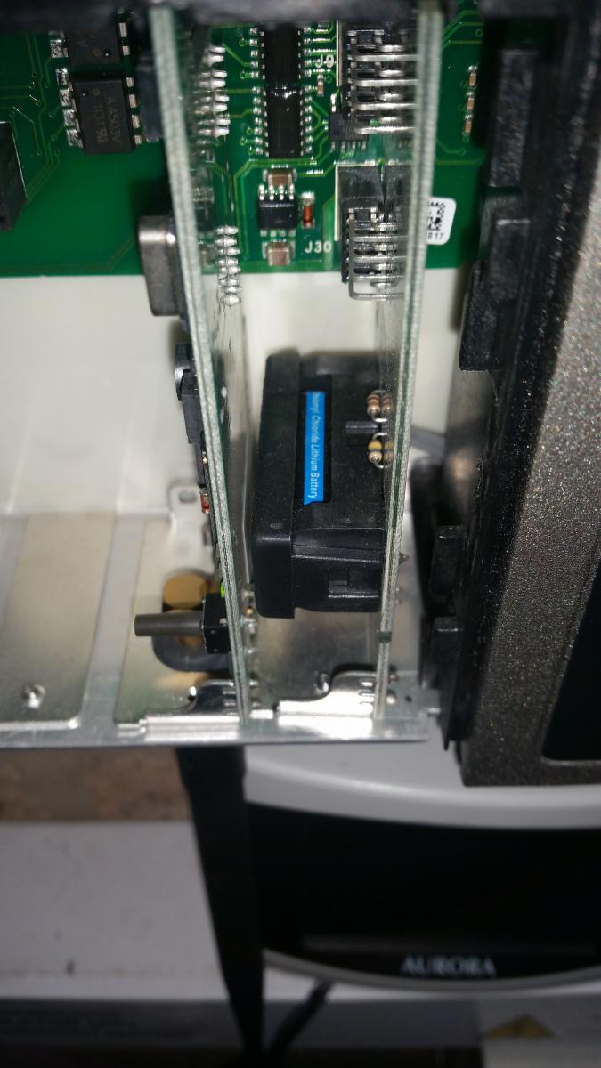

Hi all....I have the aurora power one pvi 3600 inverter ( not the abb one) and clock fail has come on in the display..its still under warranty...could it be the battery...is so what type...thanks
it has a lithium battery in a fitting on the bottom right hand side....

Have checked the docs for my circa 2011 3.6 OUTD and there's no mention of a battery which suggests it's not normally user replaceable.
