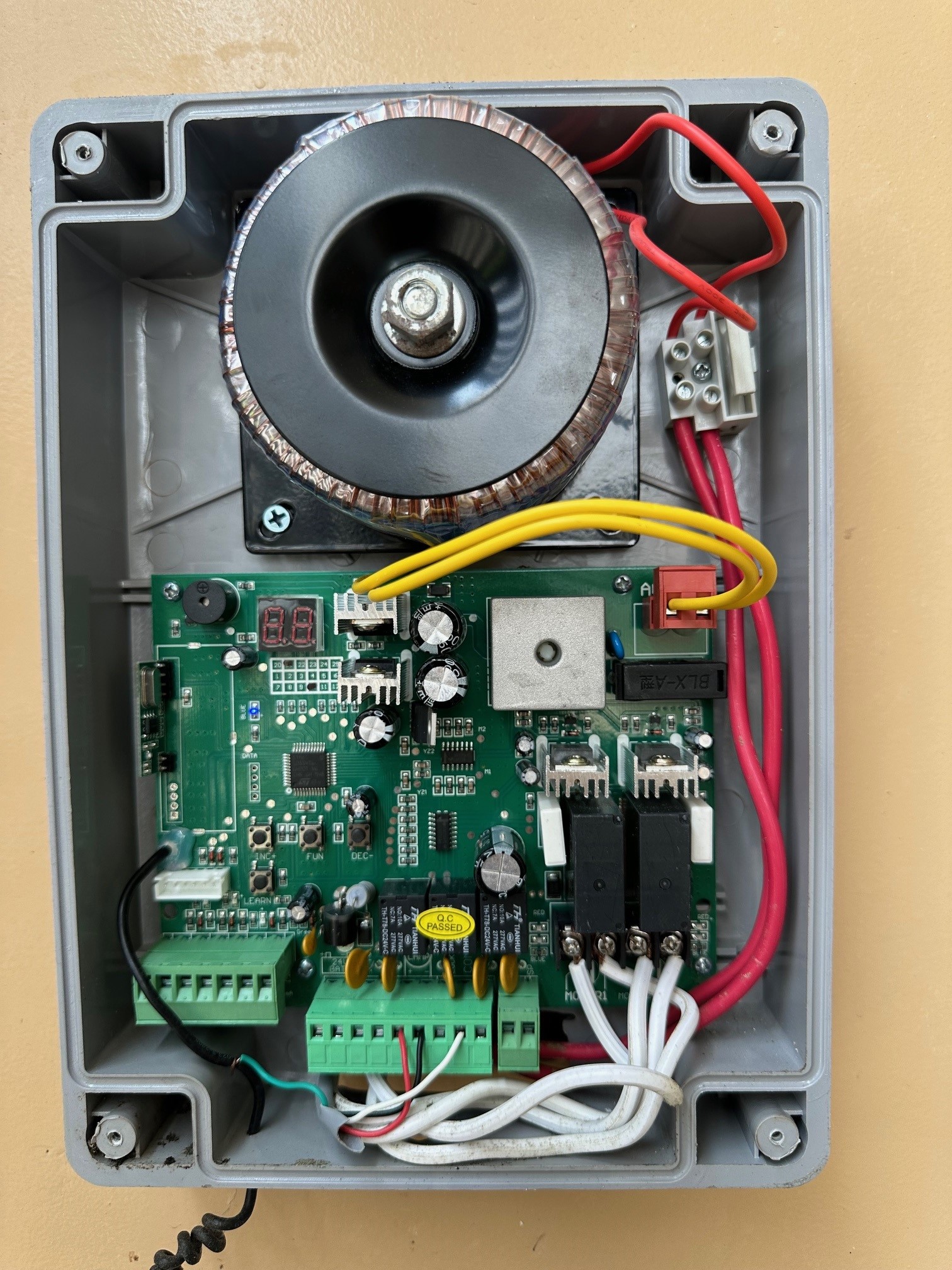

I have a automatic swing gate opener and i want to install a manual push switch to open and close the gate. I am not a professional installer just at enthusiast to DIY. can you please help me where i can connect the manual switch on the controller attached.

Google search found this
View: https://www.youtube.com/watch?app=desktop&v=97mm4HpAnho
That looks like the controller you have.
This video states it is a
PNI Mab300​
Search on that found this
On that page go to the download tab, there you will find a user guide for connection diagram and FAQ.
It tells you there what each of the terminals are for.
Of course double check that is the correct model before connecting anything up.

Great help. I will try this one. thank you.
