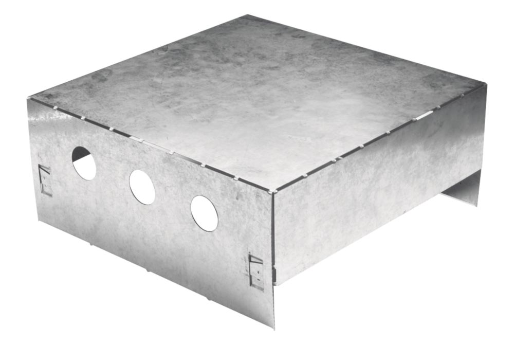

ive got a chap coming to change my db and i also want to change my bathroom lights to downlights.
these look like i can just drill a hole and put them in. i don't have to add a cover in the loft like the below as well do i?
https://www.NoLinkingToThis/p/halolite-ha-dig250-downlight-insulation-guard-220mm/97932
