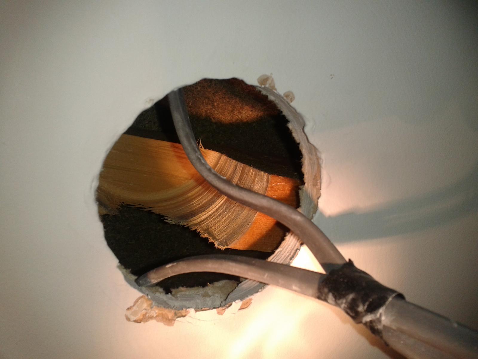

Hi all looking for your opinions on this. doing work for a regular customer. They have just moved into a new house. It has lots of problems which were caused by the guy who stayed there. The job is going to cost shed loads. So they want to avoid spaending money where it is not needed. The lights within the bathroom are at 2.35m so outside of the zones. they are protected by an rcd but they are only IP20. obviosly if within the zone would have to be ipx4/ipx5. But was looking on your veiws as to them being suitable as they are outside the zone.any help appriciated
Depends on the design of the light, according to the regs the IP rating for outside the zones is as per standard rules, however they also say that any accessory must be suitable for the location.
If the lights are above the shower then I would really recommend IPX4/5.

well there are two bathrooms. one of the lights is above the shower cubicle and ive already reccomended to chang it. the other room has a bath and they are similar type ip20 but outside the zones.

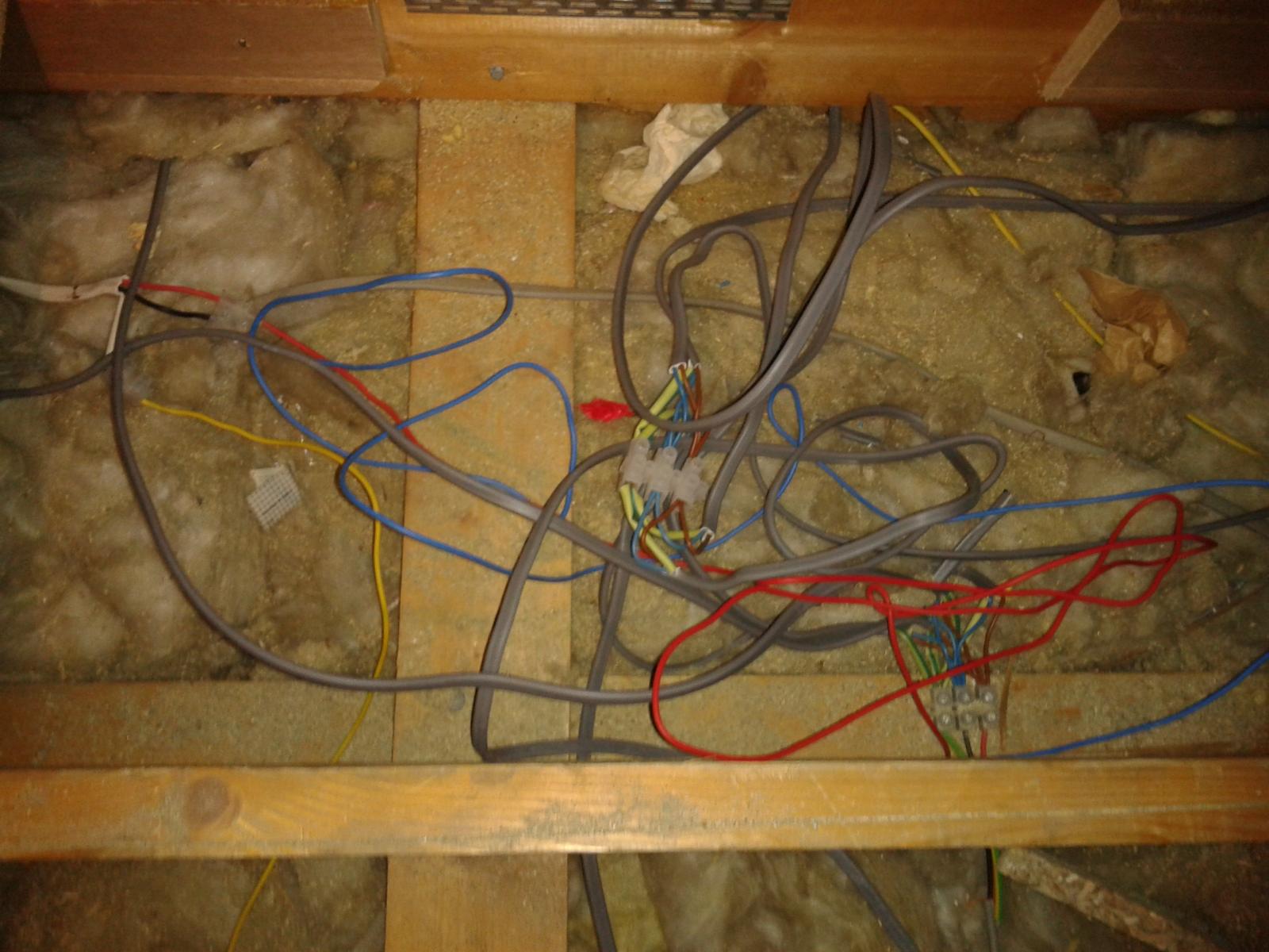

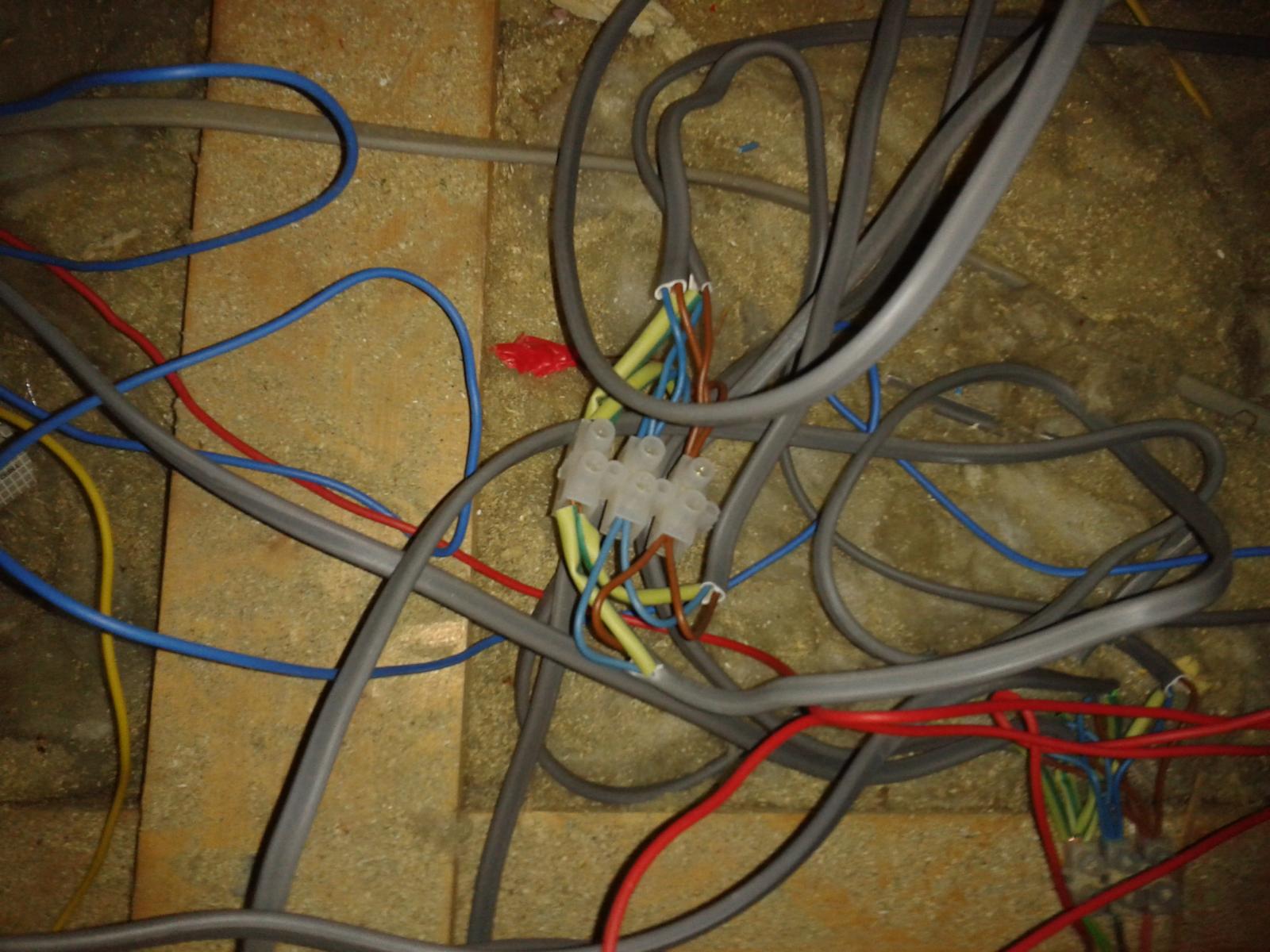

the pictures really are only a fraction of what the install is like. aparently the gut is an istrument tech on the rigs ( scary)
Note the picture of the underunit SELV lights where the metal casing is pushed up against the line conductor (230)

i must say i'm impressed with the legend on the loft board. pity he didn't concentrate his efforts on the wiring.
Worst thing is I reckon this was done by a sparks as there is lil chance of someone without knowledge making such a spiders nest and understanding it.. that to me is the scary bit
