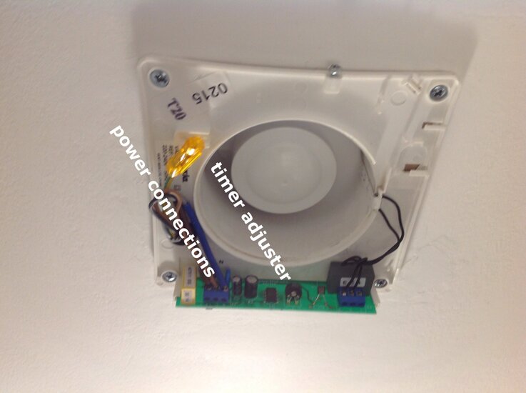

I had an extractor fan fitted in my downstairs toilet yesterday. The fan turns on when the light turns on. The problem is that the fan runs for about 15 minutes after I turn the light off. I only need it to run for a minute or 2.
According to the instructions the electrician left me, the timer can be adjusted by removing the fan grille and using a screwdriver to turn the adjuster clockwise.
However, it also states that the timer can only be adjusted before or during installation.
Does this mean that I can't adjust it now? Any advice would be much appreciated. Thank you.

Yes the fan over-run time can still be adjusted. Hopefully the instructions have a drawing showing what the adjuster looks like and where it is. When you take the cover off it will expose the circuit board and the power connections which may be live. If you are unsure how to proceed safely, please seek further assistance.

Hi Wilko, thanks for your swift reply! Good to know that it can still be adjusted. There isn't a diagram in the instructions - what should I be looking for when I take the cover off? Also, will I need to turn power off from the fuse box, or can I just make sure the light switch is off? Many thanks.
Because you have a timer feature you will have a permanent live connection - so please isolate at the fuseboard - or call the installer who fitted it and ask them to do it...

No worries - there will be a permanent live inside the fan which is needed to run the motor after the light is off. It will need to be turned off at the fuse box. Not all fans are the same, but here is a pic that will hopefully help. Please be careful and don't touch anything else, even if you think it's all off.
