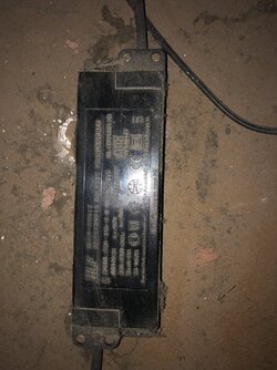

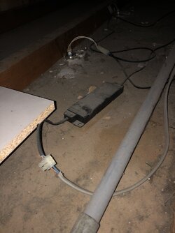

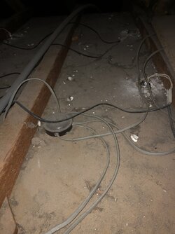

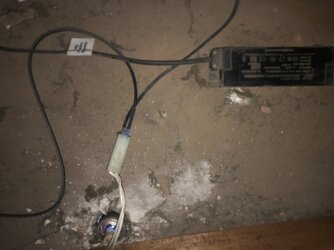

Hello, I wish to purchase some Downlights to replace some halogen spotlights in my bathroom. Currently the existing spotlights are powered through a transformer connected to a terminal junction box in the loft. Looks like the existing transformer is connected by only a two core cable.
I want to replace the existing set up with these led lights LAP Fixed LED LED Downlight White 5W 370lm - https://www.NoLinkingToThis/p/lap-fixed-led-led-downlight-white-5w-370lm/3046v
Can I connect the existing two core cable from the terminal block to the first lED light and then daisy chain the other four lights with just 2 core cable?
The new lights are Ip65 rated and double insulated.
Also, what thickness cables should be used?

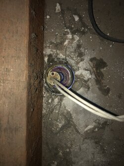

Lastly, the instructions for these new lights stipulate that there should be 50mm distance around of outside of units. However as can be seen from the existing spotlight position, some of these lights are close to the joists.
Would you recommend filling the existing holes and moving lights over?
The led will obvious be cooler than the existing lights
Pictures of existing set up attached.

I think the “2 core” cable is actually grey twin and earth with the earth cut back.
Regulations stipulate there must be a continuous earth to each point in a circuit. The fittings should come with an earth terminal.
I think they’re far enough away from joists… the 50mm doesn’t mean 50 from insulation??

Each Downlight has to have an earth up to the junction box or a junction box, to maintain the circuit.
if the light is supposed to be 50mm away from a combustible surface they have to be 50mm away from a joist.
the lights in the picture are not! they require moving if you want to do a professional to the regs job.
