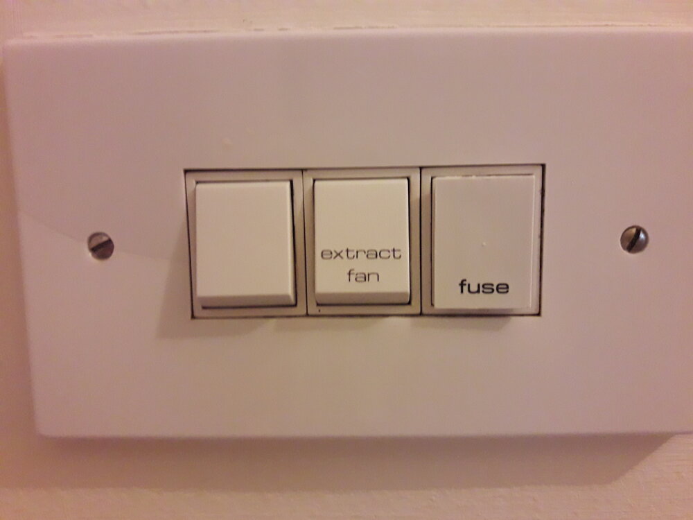

Hi everybody. Newbie seeking advice. (Photo attached) I am trying to track down an online switch for a bathroom. The first switch on left is bathroom light. Middle switch fan. Right is 3amp fuse. Does anybody know what this switch is called? And, where I can buy one online (UK)? Thank you in advance.

It’s a grid switch set up with a fuse for the fan. To replicate your will need:
MK 3 Gang Grid
MK 3 Gang Faceplate
And the 3 inserts you need.

That is the MEM Spectra range which is now obsolete although you can still pick them up. If matching like for like isn't a consideration most brands do similar ranges.
