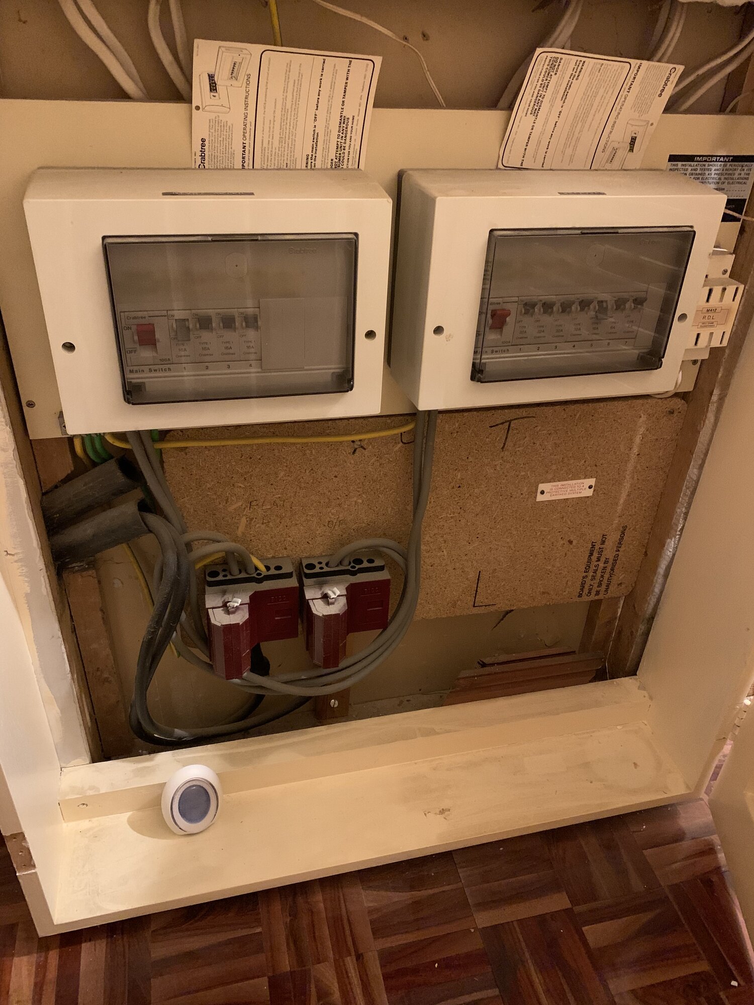

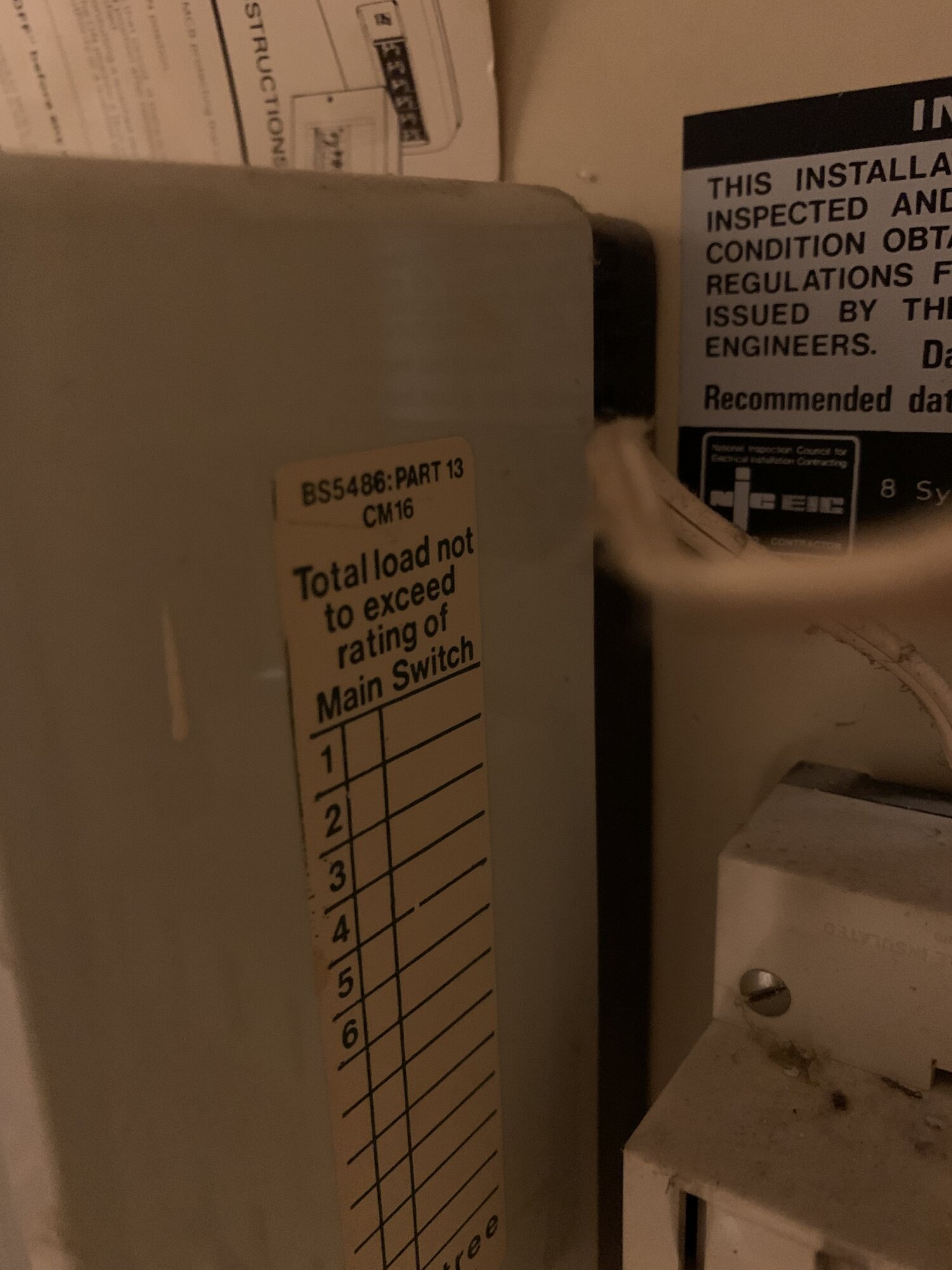

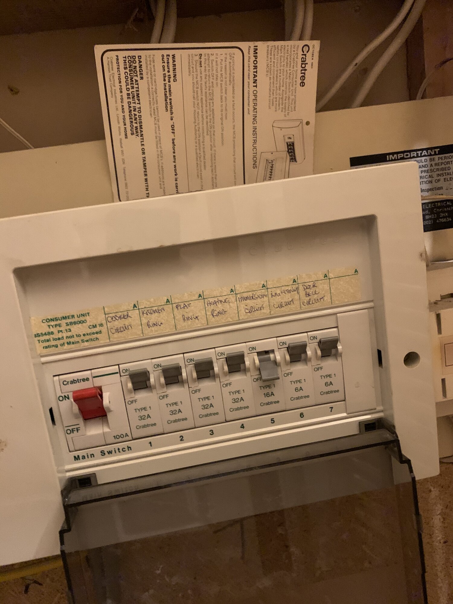

I don’t think so, here are some photos

No they are SB6000. They did make rcbos for them but were two module and would now be second hand. Finding one for a 6 or 10A lighting circuit is likely to be difficult. It is likely they never existed.
Thanks.
so the RCBO route is out really.
If I were to just replace the central light with a new modern one, would that also need an RCD?
And a difficult question to answer, but I won’t hold you to it, if nothing changes, is the Flat likely to fail a EICR on the Consumer Units alone I.e. age and lack of ECB, assuming everything else in the flat is ok?
