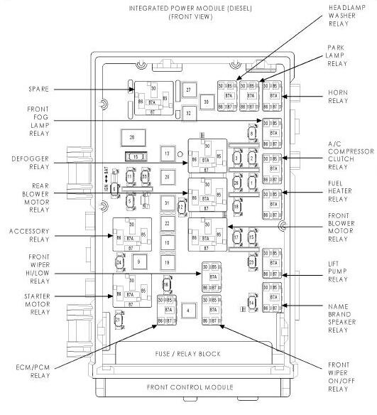

2. Chrysler Grand Voyager 2.5 CRD drains battery flat over 2 days. When I switch off ignition and pull key out, the trip computer stays lit even after closing and l8cking doors

2. Your accessory relay may have welded closed?

What is an accessory relay and where is it?

This should be (though I could be wrong) the layout of the relays under the bonnet.
Battery drain and related question relays 5170612400_1347645933 - EletriciansForums.net
I believe (though I am not experienced in this area) that the accessory relay should switch off when the ignition is switched off, you should hear a click from the relay, and you may be able to feel a slight tremor if you are touching it, when it disengages.
If it does not operate then it may be that I am wrong and it does not switch off with the ignition or that it is not operational.
However I would try and get more detailed information, and try Tel's suggestion above before starting to swap out parts.
