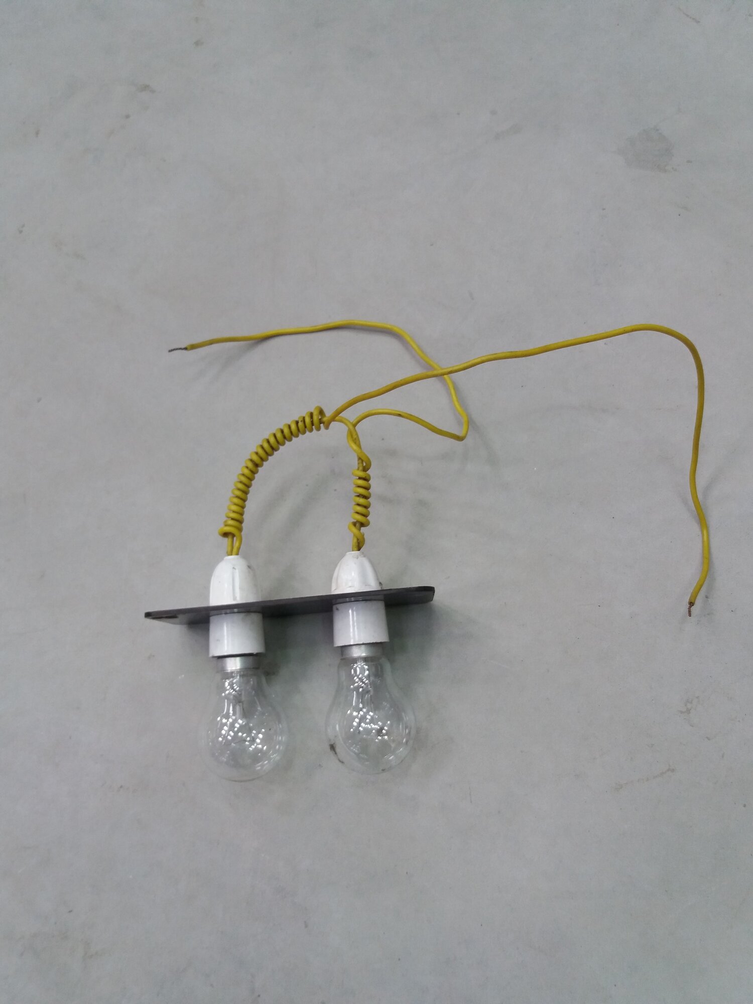

To bell out, is the old way of testing for continuity, and it was a simple doorbell circuit.
nowadays, a multi function tester can send anything up to 1000v down the wire, so not only does the circuit need disconnected from mains, but any electronics or other devices need disconnected from the circuit. Ie, smoke alarms, led lights, anything that can be unplugged!

As above 'belling out' using a battery door bell was to prove a pair of cables were simply continuos with no breaks in either wire

advances in technology.cvwe now have these wonderful machines. batteries not required, and the magic needle eliminates the need for buzzer:
Didn't we all start off with one of these??
Still have mine!
