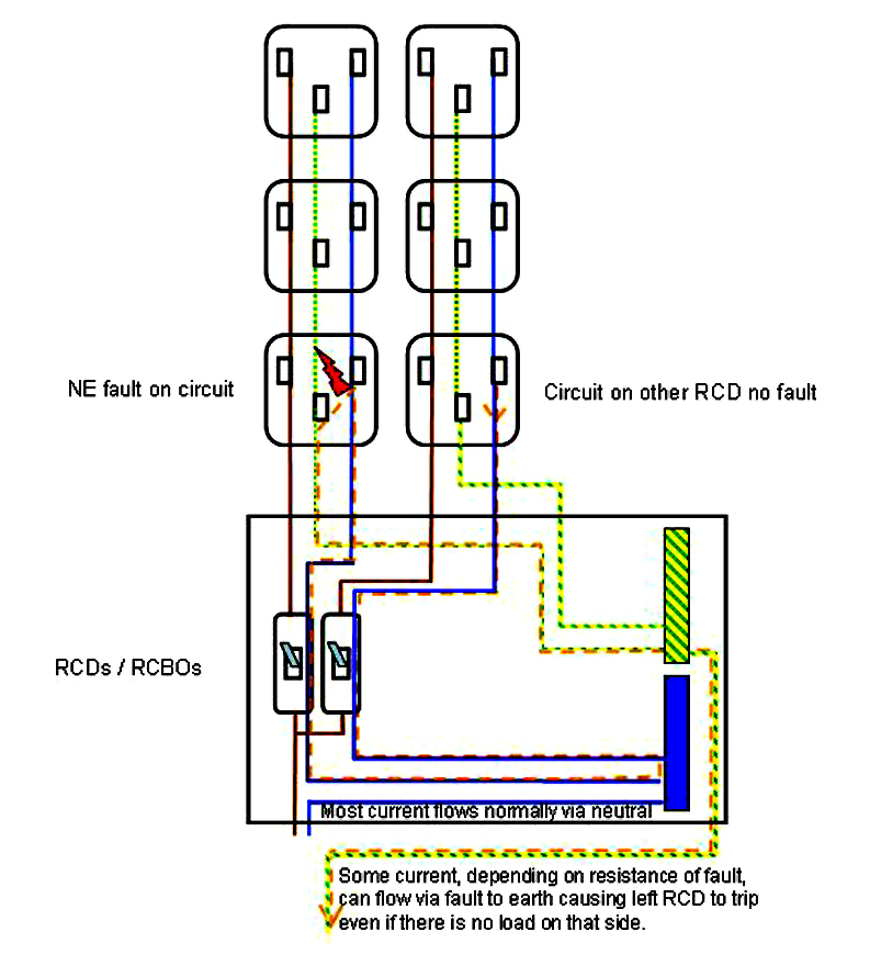

Tel has covered it really, if there is already a NE fault on the upstairs ring the RCBO is tripping when the leakage current and test current reach (say) 24mA but the leakage of (say) 9mA causes the test current to only read 15mA.
Previously posted diagram of NE fault causing RCD to trip, the fault is on the circuit that trips even if the load is on another circuit.

The ramp test at which most are tripping at, 24ma is low. Manufacturers do not design a device to trip at 30ma and allow some leeway normally around 27ma.
Agree there's likely a cabling fault. Also, if rcbo is isolated from the circuit it should not trip at 50% of rated current, just saying :)
