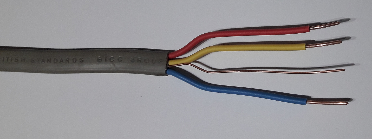

I have a load of that cloth covered poly butyl jute cable somewhere in a few sizes. On the subject of unusual cable, anyone else come across 2.5mm 3core and earth? This cable is made by BICC and has a 1mm CPC. Was used for a 3 phase supply to a fan motor for a hot air heating system.
