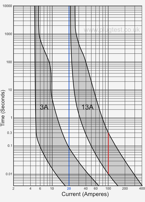

Just to mention that 13A fuses need a significant overload to blow quickly. They pass <20A for ever.
