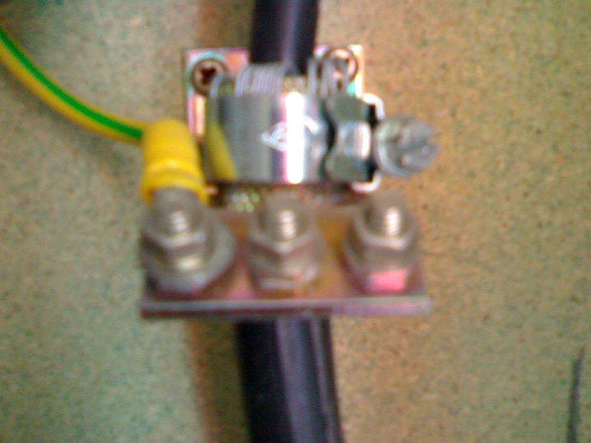

We all know that armed cables should be bonded but I have inherited a job of a so called electrical contractor. My problem is he as ran 2 core 16mm SWA to 3 flats with a separate 16mm earth but the SWA has not been glanded off, and it’s a finished job.
I can not pull out and start over so does any one know of any other way to earth the armouring without glanding off. Please no Tenby earth straps

In short no. To effectively earth the armourings glanding off is the only way. Are the armoureds surface run or hidden in walls?? Could you not install a metal adaptable box above/below the CU and gland into that?? contiunuing the cores through and earthing the armoudes that way??

this is not my recomendation they do need glanding, but if you are in a muddle you could strip some outer off to expose the armour, you could solder a fly lead on each end and terminate it that way (rough though)
Luckily as it's not the circuits cpc only one end needs bonding, so as markspark666 suggests you could strip the outer sheath then pull the strands to one side, trim them to the same length and find a crimp lug that's a good fit.
It won't look very smart but perhaps you could find something to overwrap the whole thing.

My fist thoughts where to go down the lines of what is used in the jointing kits i.e. sprung steel and earth brads any thoughts on that as i only need to protect the SWA from any impac(nails/screws)
when i first used the coiled spring clamps i thought they were **** but changed my opinion as the do get a good hold and visualy they would look better than a tenby ,but you would have to use an earth braid and could you term the braid into the earth bar in the cu.

Has anyone ever used these, I've seen them used in lamp posts but I've never been able to find anywhere that sells them.

See BS7671 522.6.6 (i) Incorporate an EARTHED Metallic covering etc etc cables complying with BS5467 SWA
So armouring must be earthed even if not being used as a CPC
Reg 134.1.1 Good workmanship by competent persons ..... proper materials.........Equipment shall be installed in accordance with the instructions provided by the manufacturer....
The cable should be properly terminated in accordance with manufacturer instructions = GLANDED both ends and SWA earthed as should any other exposed conductive part.
I suggest you dig it out and do it properly if thats part of the contract otherwise report it on the PIR as an observation and recommend cable is correctly terminated
Go with the earthing coiled springs and braid. I wasn’t impressed with them the first time I used them in joints but when I tested them before sealing the joint I changed my mind. The one I used had half moon sectors that went around the inner serving and pushed down under the armourings then the clamp went around the whole lot, they were absolutely sound.
Yep used them myself many times with both braid and multi stranded flexible cable, with a heat shrink breakout overall covering the earth termination and the complete end of the cable.
All SWA cable terminations on high end projects will incorporate heat shrink cable breakouts, they seal the cable completely against any moisture ingress.
