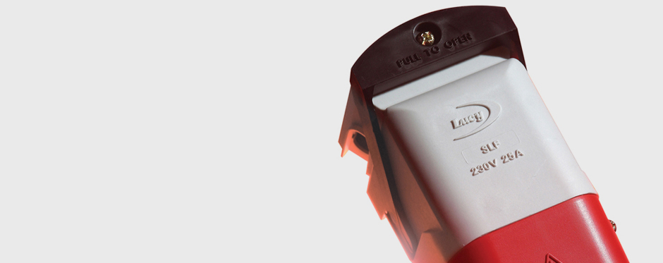

Not sure what your after but normally use Lucy street light cutouts.
