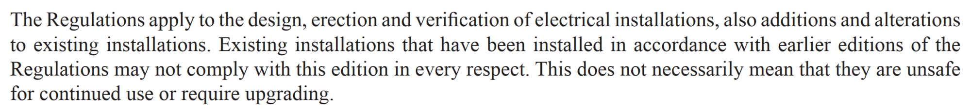

A Landlords EICR is to ensure compliance with the 18th edition of the wiring regulations !!
I agree that is what the recent law says, but I don't think that is the end of the story.
The relevant legislation is the "Electrical Safety Standards in the Private Rented Sector (England) Regulations 2020" and can be viewed here: The Electrical Safety Standards in the Private Rented Sector (England) Regulations 2020 - https://www.legislation.gov.uk/uksi/2020/312/contents/made
“electrical safety standards” means the standards for electrical installations in the eighteenth edition of the Wiring Regulations, published by the Institution of Engineering and Technology and the British Standards Institution as BS 7671: 2018(3);
3.—(1) A private landlord(1) who grants or intends to grant a specified tenancy must—
(a)ensure that the electrical safety standards are met during any period when the residential premises(2) are occupied under a specified tenancy; etc.
BUT personally I think this has ended up a little ambiguous and needs to be tested in court. I don't have the BBB here but there is (or was?) a paragraph saying something like - "Existing installations that have been installed to meet earlier editions of the Regulations may not comply with this edition in every respect. This does not mean that they are unsafe or require upgrading"
So the law says the installation has to meet the electrical safety standards, and the electrical safety standards say that installations to earlier standards don't need upgrading. (paraphrasing). So where does that leave us?
As already posted above, my answer is BPG4.
BPG4 does have examples where they should be treated as retrospective, for example outside sockets not RCD protected being coded as a C2.
So I'm very happy to try and follow BPG4.
I'm not going to tell every landlord they need a shiny new metal consumer unit.
I am happy to tell them that their pond pump needs RCD protection though.
C3s putting you in harms way ?? 1617546116557 - EletriciansForums.net
I don't see that there's a conflict. Ignoring the problem that they used the word "comply" when they really should have written "conform", it's straightforward enough - the Wiring Regulations do not require older installations to be upgraded.
That doesn't stop something else, e.g. a law, from requiring it.

I didn't actually mean to suggest a conflict in that sense. More querying how one relates to the other. If the law says "electrical safety standards are met" with electrical saftey standards being defined as BS7671, I can't decide if that means it needs to meet BS7671 in all regards as per a new installation or if it allows BS7671's own provisions for older installations.
