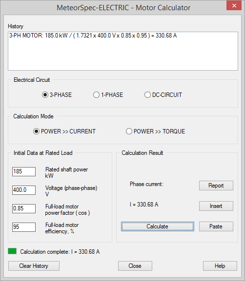

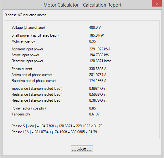

Hello,
If you were using a 4-wire cable, then I would advise the MeteorSpec software to choose and check cable cross-sections. The MeteorSpec has the motor calculator and the cable current-carrying capacity calculator. The freeware version supports only 3-phase symmetrical networks with 4- or 5-core power cables.
I made calculations of load current with power factor = 0.85 and motor efficiency = 95%.
To perform any electrotechnical calculations in a complex electrical circuit, you must first build its model. With the MeteorSpec you can calculate all parameters in low-voltage networks.
To calculate short-circuit currents at the consumer I made a simple preliminary model with one Cu-cable section 2x(4x120mm2) from a transformer to the motor. If the real network has a complex structure, we can freely simulate it if need.
This preliminary model is build having an imaginary data of the transformer.
According to the preliminary model the minimum SC-current (1-phase at 90C) is 6.8kA. Then, for 400G500M fuse the disconnection time is around 1sec. Of course, if the feeder from the transformer to the motor consists of several cable sections, the disconnection time will be longer.
If you can send me the all cable data (CSA, lengths) from transformer to the consumer and the transformer data, I can make an accurate model of the entire feeder and calculate the SC currents and voltage losses at each node and at the end of the feeder in operating and starting modes.
