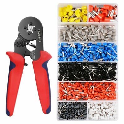

If you do a lot of this (unlikely) or are using fine stranded wire in terminals that are intended for coarse stranded (7 strands) or single-strand then a "bootlace ferrule" is the answer. For typical 13A plugs and accessories the uninsulated sort are best, as the ones with the plastic shroud take up too much space. While you can get tools covering a huge range of prices, the self-adjusting kits from the likes of eBay/Amazon are your best bet. For example:
Mostly the are kits include the insulated ones, you can snap the colour-coded plastic bit off if you don't want to buy a pack of uninsulated ferrules.
