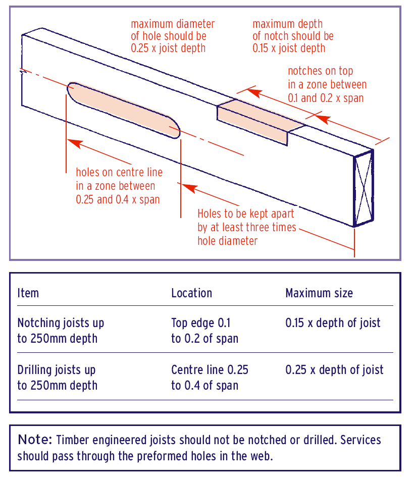

Talking of the guidance diagram in the OSG, is it acceptable to make oval holes in joists, as it shows, formed by joining up two adjacent holes? I ask as the diagram shows an oval, but the text only mentions holes, and that they need to be three diameters apart.
How many electricians actually adhere to these rules, ie holes 2 diameters apart, only within the 0.25-0.4 x span zone, etc? Most I have seen in my limited experience don't.
I'd say no, simply because of the minimum distance between holes required?
I wish they'd change the diagram to show two correctly spaced holes, and not an oval then! I don't see the problem with a slot, really, as the centre part of the joist takes very little load, which allows 'engineered' joists like this to work.
I think you've misunderstood the diagram. The shaded brown areas show the permited locations for notches and holes.
It's not an illustration of a notched or holed joist. If it was, you'd see the material thickness through the hole.
Ah I see what you mean. Trouble is, in the OSG version, it does show the shadow of the material thickness. I would have thought that a slot would be less weakening to the beam than the equivalent separate holes. Still, I,m no structural engineer, what do I know...?
