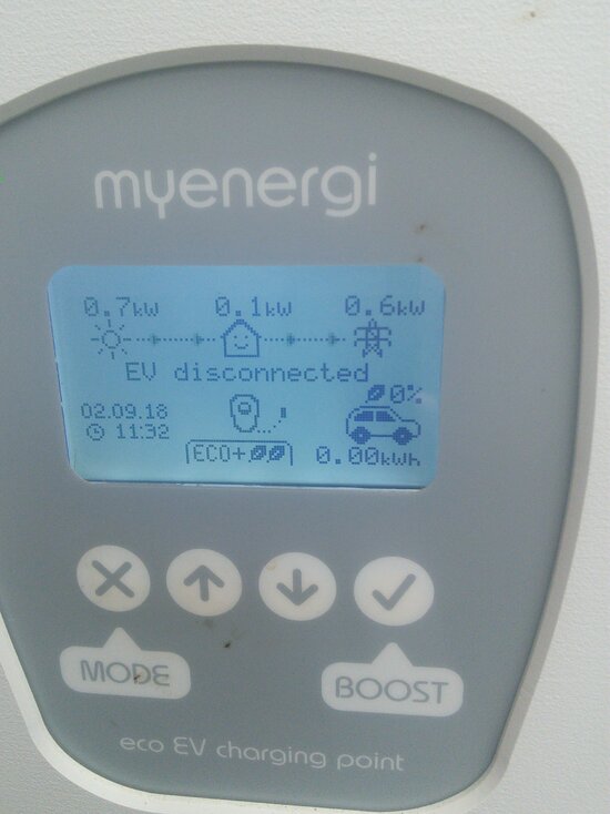

I had a basic Rolec but changed it for a Zappi smart charger.. they seem to be ahead of the game in terms of integration of solar PV generation. Next step is Grid sharing to balance out demand..
It's not so much like an Apple burit does seem to be the only/first domestic smart charger. I expect others will follow..
