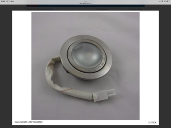

It's most likely a 2w reflector LED lamp as the link below, unless the hood is an old one then it may be halogen.
Twist the lamp anti clockwise, rubber gloves may help gripping it, then it will drop out, it'll say on the back of the lamp what type it is.
