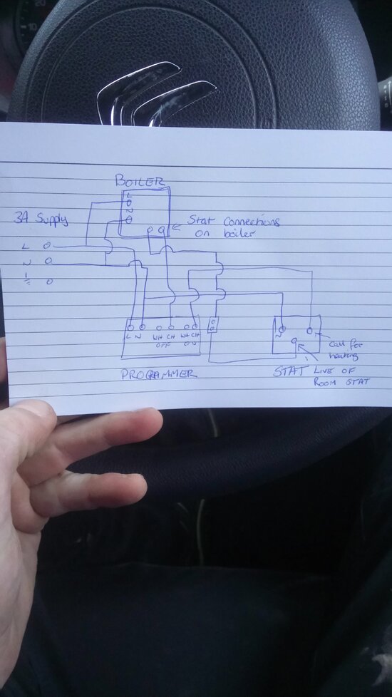

A client has decided to attempt a dual programmer replacement and made a mess, i have reconnect everything as following but the boiler and programmer arent working together, just wondering if any one would have a look at the connections to see if i missed something or if they have another idea about issue, we have a Drayton dual programmer with a Drayton room thermostat
Connections to programmer as flows LNE from switched fuse, i then have the core from the room stat that calls for heat on to the CH on terminal of the programmer, the feed to the room stat is joined in a connector with the a core that runs out to the boiler (connected to one of the room stat terminal at boiler) i then have another core to do with the room stat that comes from the boiler connected to CH off on the programmer
As i do not do a lot of this line of work am just seeking advice thanks

We need Boiler information and a drawing really.
Just to be aware.. If it is a Combi then is worth investigating properly different boiler manufacturers have different ideas. Some makes of boilers like to make roomstat controls volt free. Most dual channel programmers send out 230v to CH and HW termnials so be careful you don't blow up the boiler
Not sure what the ch off is doing, don't think it is required.
Ch on to room stat as you show, then to boiler (terminal usually market rt) - the switched live return. Often there is a link which needs to be removed when using external controls

You need to go into "common" then CH on terminals of the Programmer.
You probably haven't got a common terminal on your Programmar though because on 2 CH programmers it' usually linked internally to the perm Live.
That's why it's important you check that the room stat terminals take a voltage.
Why not use a single Channel Programmer if it' a Combi ?
Verify its a combi first if so, put a link between the stat terminals on the boiler to make sure the boiler still works and you haven't stuck a voltage through volt free connections.
FS terminal on the boiler to Common on the Programmer
FR terminal on the boiler to Call for Heat on Stat
CH ON on Programmer to L on Stat
If no Common on the Programmer, take FS from Boiler to L on Programmer and put the Perm Live current there into a choc block or the like.
