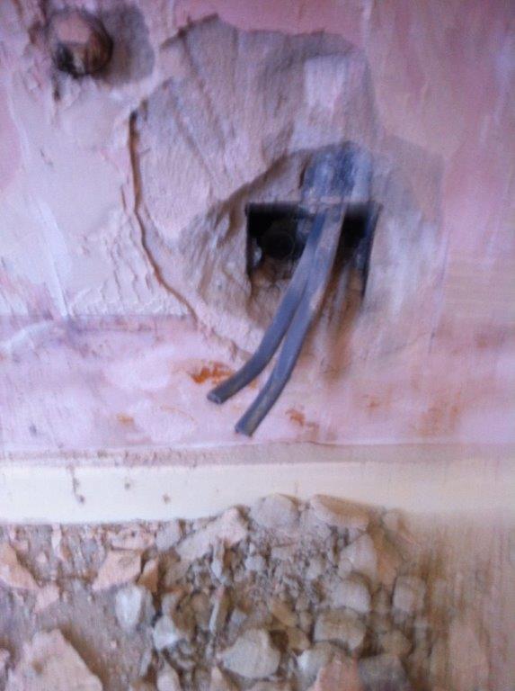

Without Sorry for boring the pants of other members, pictured below is a socket I discovered when a new kitchen had been installed in a house. It was a socket on a ring final, that had been plastered over when the house was built circa 1960, the ring was changed to two radials in 2011 when someone replaced the CU. The cables were still live, until hacked out the plaster to reveal this old fossil, and disconnected from the radials.
