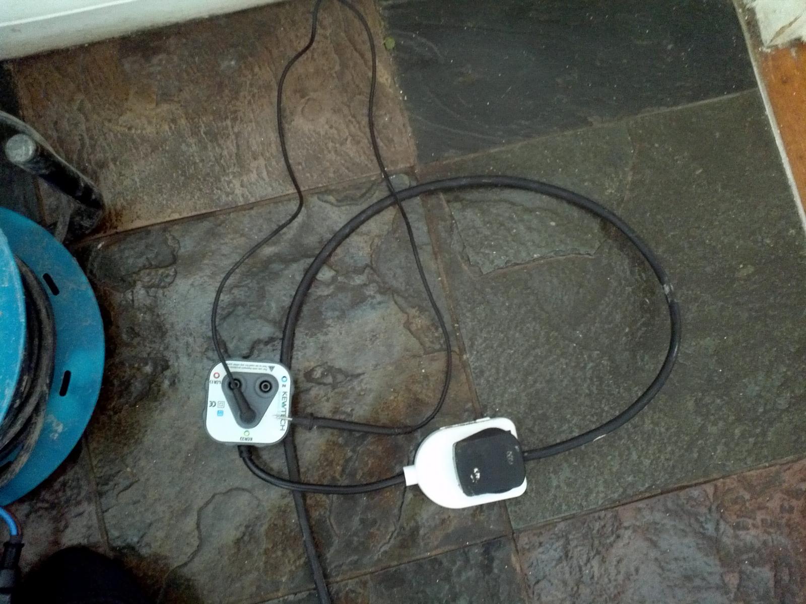

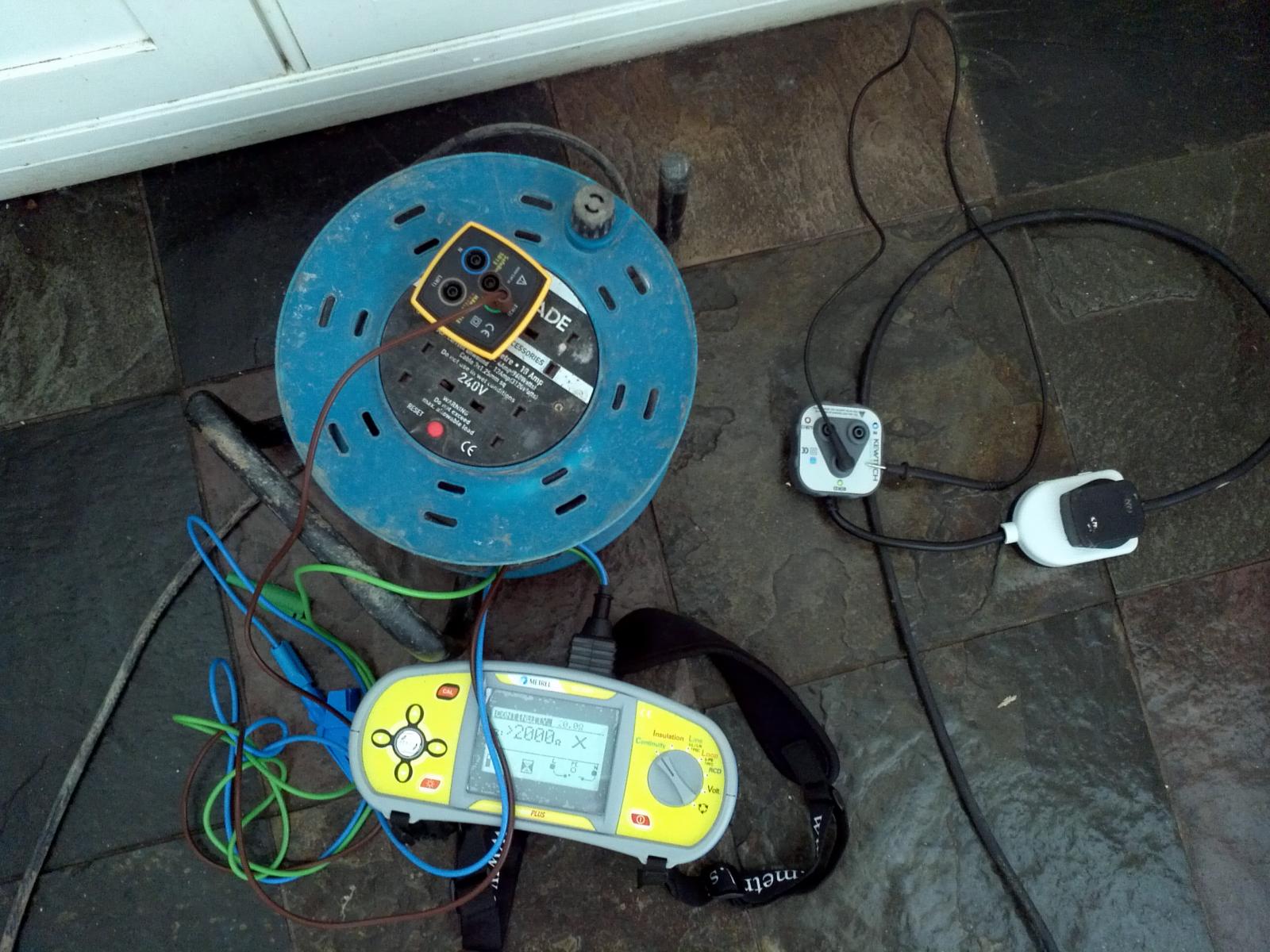

i was looking into buying a extention reel for measuring and came across a kewtech gadget that uses any household extention lead was thinking about what i had in my tool box already and made this set up all i am missing is a test lead with crocodile clip attachment what do you think?cheap extention lead set up IMG_20120819_115801 - EletriciansForums.netcheap extention lead set up IMG_20120819_115812 - EletriciansForums.net
would my assesor be happy?
it works! anyone else thought of this? if anyone wants to buy a simillar product i will sell you a set for 50 quid not including extention reel or postage.

I have one of these & after I bought mine I think Tel. got one as well electricians R2 30 metre extension wander lead for Megger, Fluke, metrel etc | eBay
It's fine & does exactly what is says on the tin.
i was going to buy one until i thought up this way,but why stop at 30 metres why not 50 .
my way you can use something you own already use as many extention cables needed ( within reason, cheap and less lugage to carry around.
The extension lead cobbled together with socket adapters and all that seem great, but it soon become a little cumbersome what dragging it all about on an EICR.
You then think forking out for a proper R2 lead isn't a bad idea after all.
