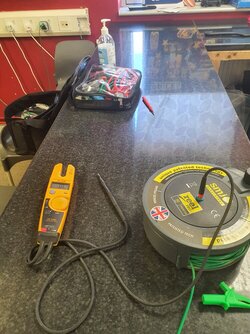

Yeah ive got a 50m R2 lead, and have indeed been using this to get readings to known earths. My suspicions were correct in that some fittings were not earthed. Although Zs was obtained from the end of lines. I was not happy with earths being blocked, then fly lead off to the fittings. So now every fitting has been checked, and the ones which had lost the earth have been fixed. All agreed with client for extra cost. So all in all a good result.
