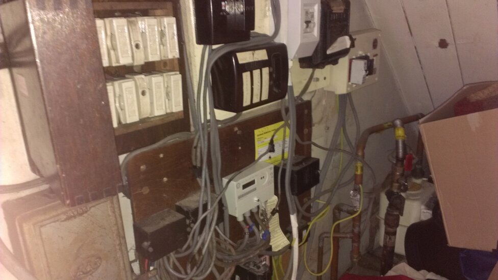

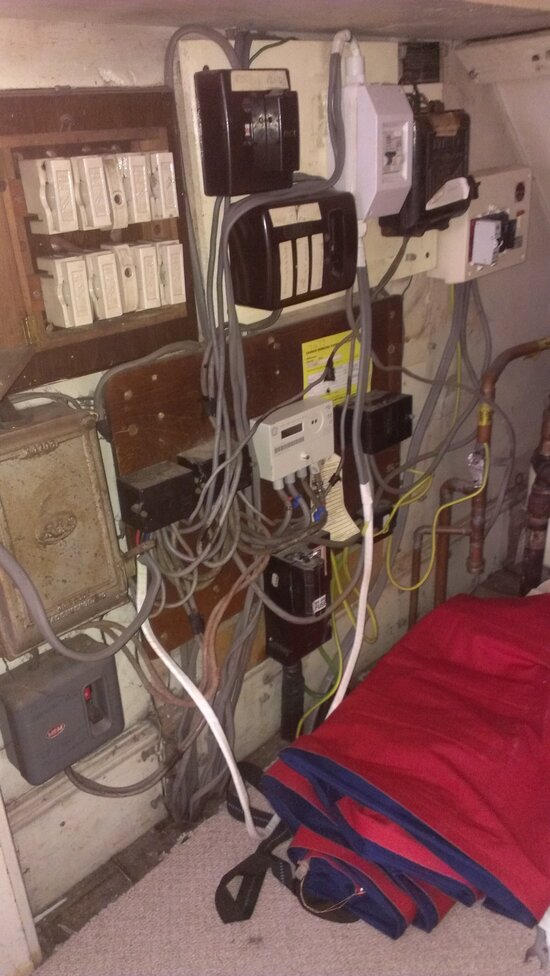

Today I removed a fuse board from the 1940s/50s that was supplying the lighting circuits in an old house. None of the circuits had cpcs, the neutrals were fused, the wooden door could be opened without a tool or key and the fuses could similarly be removed. With fuses removed live parts were accessible that were easily touched.
It could well be that all that complied when installed, but had I successfully established this by accurately determining the install date and checking the relevant regs, would I be right in saying no codes were appropriate ?

Any photos of the board?
Never seen one with a wooden door.

Obviously a degree of common sense has to be applied during EICRs, and if I came across anything as shown in the pictures....then it would be deemed unsatisfactory for several reasons.
This is where judgement has to be applied....
