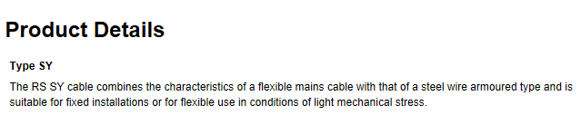

Just out of general interest but RS SY cables are ok for 'fixed installations' according to them.
RS Stock No. 522-676
So they are unsuitable for fixed wiring?
I think this is what they are going to change it to.
Note
SY control cables are not suitable for fixed wiring applications requiring compliance with the requirements set out in BS7671.
