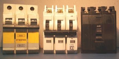

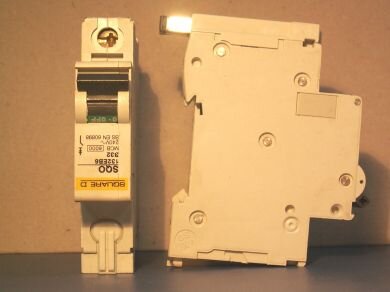

the Enclosure is Square D but im struggling to find the correct breaker?
and will any other make fit Square D!!???
Square D have released several MCB types over the years, They have 3 MCB styles currently on the market - Domea, KQ & SQO. Although the KQ & SQO look the same.
In the past the you had the QO & QOE`s there are 3 MCBs in this range which do look different, but have the same Electrical & Mechanical Fixings.
From the front: - one is black
one is grey with rounded corners
the last is grey has square corners & a yellow stripe
I would recommend you use a type C for your application.
Couple of pics if that helps.
looks like the first one!! the newer version! i only had a quick glance at it, may have to return :(
is any other breakers fit square d???
Not q types as far as I know.
Spent ages looking for q type square d stuff before, found that recon electrical tend to keep a lot of older stuff that fits.
The one on the left, I tried getting a D type they're rare as rocking horse... they stopped making them before the breakers were phased out :(
